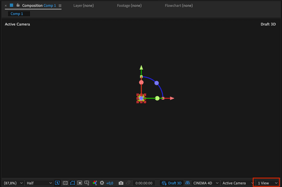

Since I updated After Effects to the 2021 version I have a double view window (Front/Top). I can't find the option to switch to 1 viewer. Where is the option that was always underneath the view window?

Try to activate any of your composition layers into a 3D layer. Then AE should display that option

In the right-bottom of the composition panel. Select "1 View". Check attached image.

The problem is, that option dissapeared after my update. See my picture.

Thanks a lot, this works. You made my day!
