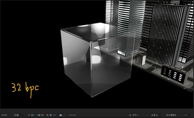

The problem I encountered was that when making glass objects, the colors in the ae e3d composite were lighter and grayer than the colors in e3d. The solution I finally found was to adjust the color depth to 32bpcQQ_1746284964486.pngQQ_1746285035200.pngQQ_1746285058604.png
