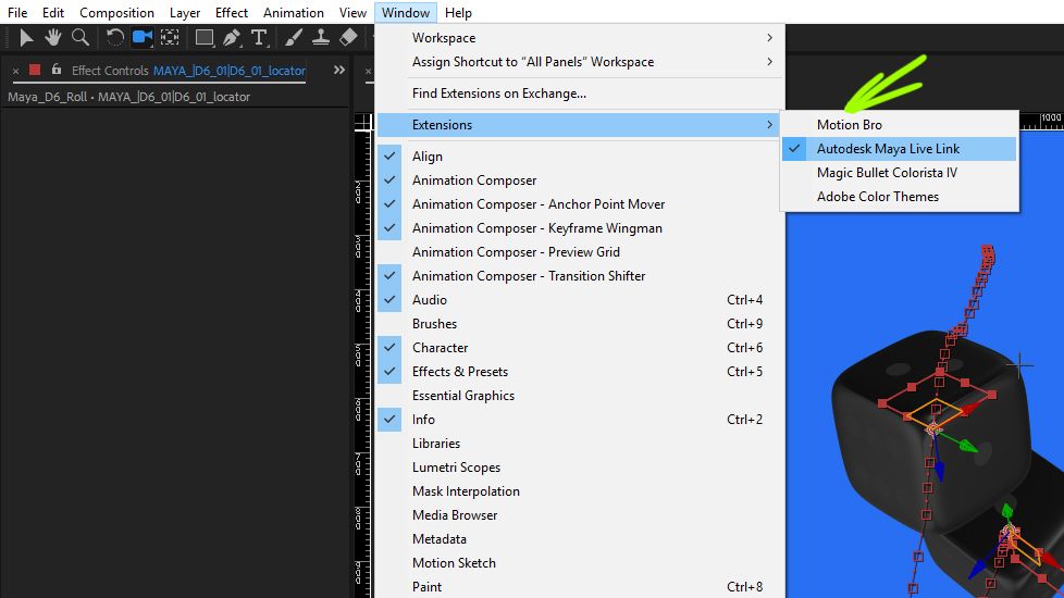

Hi, people! If anyone is still curious I have found a solution that worked for me.
I have created a simple simulation in Autodesk Maya using Bullet Physics and baked it (don't forget to put locators in your geometry BEFORE you set up a simulation). Then I run an Autodesk Maya to After Effects Live Link (it's an extension which you can use to export cameras, locators, planes, etc. to Adobe After Effects, more info on the link). You need to lunch it in Maya and After Effects (see the screenshots below).
It will allow you to have the Position and Orientation data in keys. After that, I made a Solid with Element 3D on it, set up my two D6 with a custom texture map (I need to have control of what is on the dice's faces and also animate it). In Element 3D you can create a Group Null which you need to parent to Null Objects from Maya and now you got your physics simulation but with 3D fully controllable from After Effects. Set the lighting, animate your camera and get your job done. Two additional screenshots of work in progress below. Peace!
