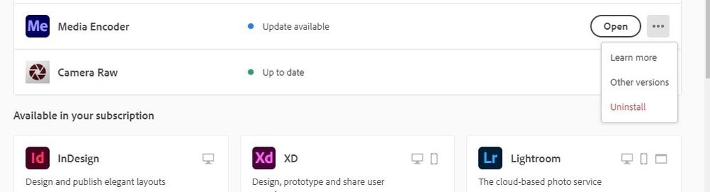

You go to the cloud app. Click the three dot menu next to Me and select other versions. Click the version you want and it will uninstall the current and replace it.SharedScreenshot.jpg

I just want to vouch this fix. Got a webm with alpha. File was still a bit bigger than expected. (3.2mb) on a 2 second transition, but I am sure I could have tweeked it. My assumption here is the author has not updated the adobe exchange to the latest version and some change in the version is hiding the alpha checkbox. By going back to v14.3 and using legacy install from creators website I was able to get the desired result. Thank you for the fix. I'll stay on this version until I know there is an update to the plug-in.SharedScreenshot.jpg
