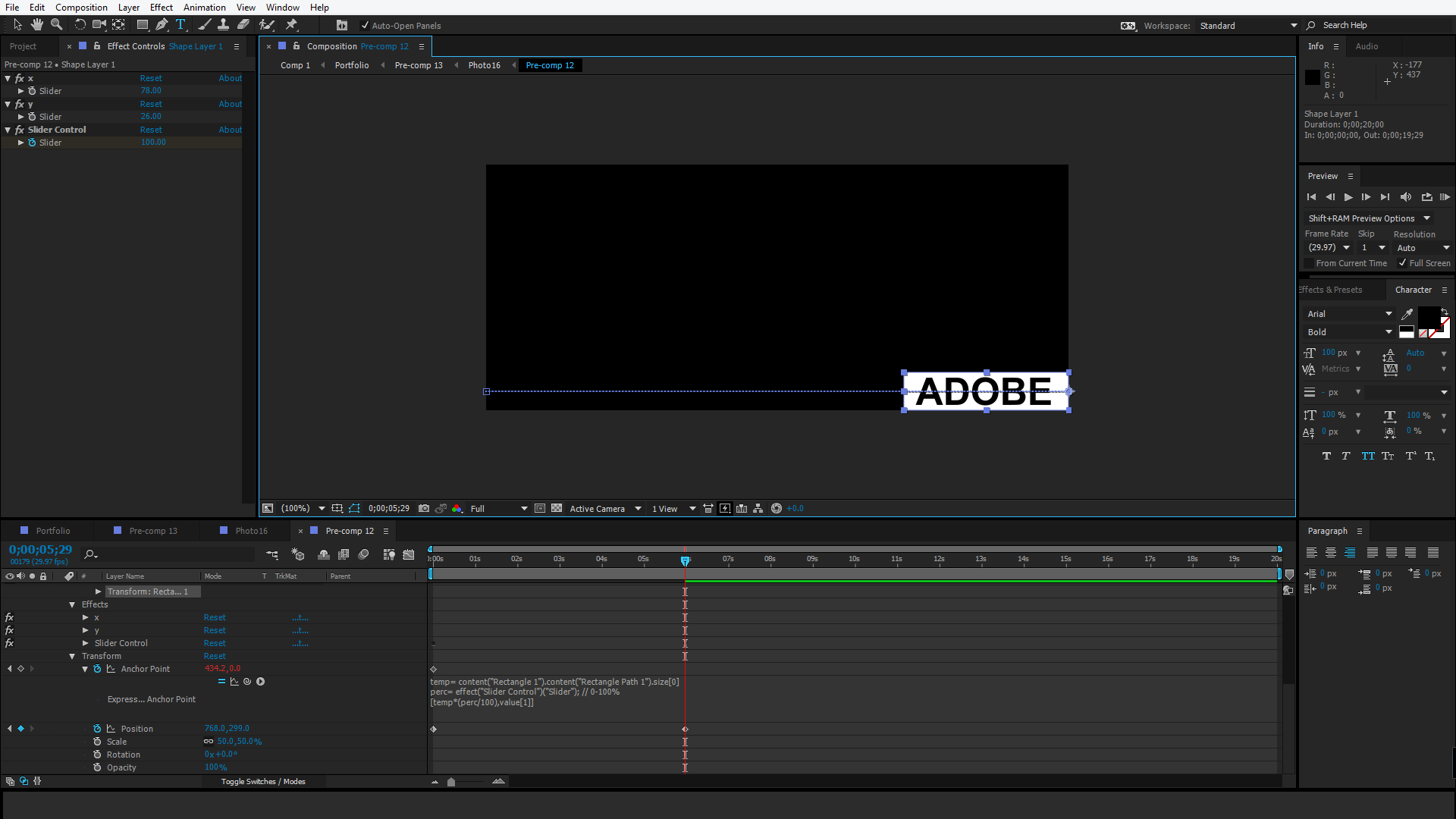

Engaged ,
Feb 10, 2015 Feb 10, 2015
Can you give me more a little help?
How do I apply it to this expression?
temp = content("Rectangle 1").content("Rectangle Path 1").size[0];
[temp, 0]
This expression is the anchor point.
That are following the size of a shape.
I want the slide control, control the size of the shape in percentage.
See image.

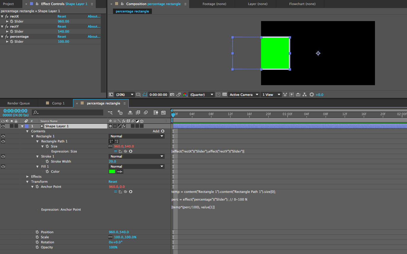

Shape layers are unique because there are several places you can control transformation (and anchor point).
Moving the anchor point of the LAYER value is going to give you different opportunities than moving the anchor point of the Rectangle (contents object)
The benefit of a Shape Layer is that it is continuously rasterizing.
You may need to consider what you need to do with this first (why expression).
Perhaps a simple scale value is all you need
BUT:
Here are two options
USING PERCENTAGE SLIDER
USE SCALE WITHIN THE SHAPE
Engaged ,
Amazing!
You are very intelligent!
I did it!
Thank You so Much!
See:
It's because I'm creating a template, now makes it easy for the person to edit.
Why is the word changes size, so I want the word never to leave the image composition.
