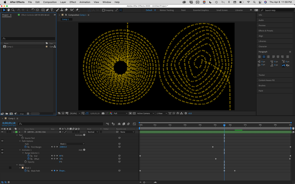

I created a spiral in Illustrator because it is easy, copied and pasted it as a mask path on a text layer, then used this page to generate 2000 random numbers from 1 to 1000, then copied them and pasted them to the text layer and added an opacity animator. The string was so much longer than the path that I added a bunch more points and ended up with this:
Here's the project file for you to look at. I think you have a bigger problem with your expression than you do with the idea and the capability of the text layer to contain enough characters.
