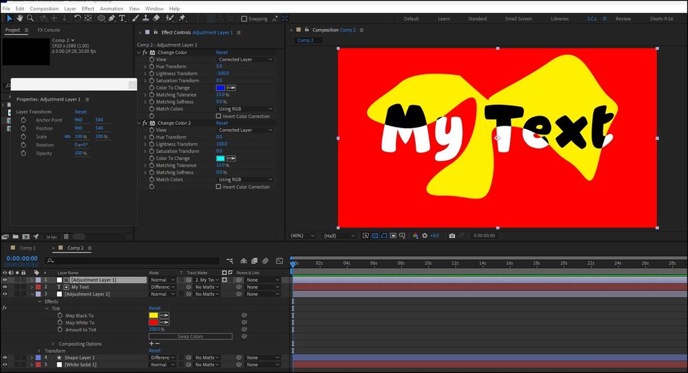

While you can use an Expression and I see Dan has provided one, you don't need to do anything as complicated.  You can do exactly what you're asking by using a transfer mode.
Use White Text and a White shape with a white background but set the text's and shape's tranfer mode to Difference.  You can then use an adjustment layer to change the background colours and a second one with it's track matte set to the text to change the colours of the text:
Explorer ,

Hi ShiveringCactus!
Appreciate your answer, I'll make sure to give it a try whenever I have to go through the same issue again. In this case, I was looking for an expression as it's not for a project of mine, but a MOGRT.
I wanted to turn this into a MOGRT so editors can use it without overcomplicating their workflow and having to explain new things for every new asset, even though maybe this overcomplicated my process a bit, but that's my job I guess haha
