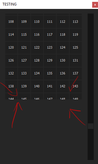

Hi guys,
I created a scrollbar and activate him in my script,
but wen i use scrollbar my buttons that down are cat...
what can I do to fix this?

Thank you very much !!!
Still buttons are cut when I use a scrollbar (If I resize the panel)

Which version of After Effects are you testing the script in? Sometimes this can make a difference when dealing with UI stuff. There have been issues in the past between versions.
From what I can see on my end, is that it all works just fine until the total height of the btnGroup exceeds the height of the monitor screen pixel height. Unless this is a false positive, it appears it does not want to draw beyond that range from what I can tell. If you resize your panel to the right or left you regain the buttons. Not sure if this is a ScriptUI bug, or if there just needs to be different math to compensate for the screen height limitation, or just a built in ScriptUI cap to prevent stuff getting created outside the screens max viewable area. I did a screen capture of this script running in CC 2014, CC 2015, and CC 2015.3 on Mac (OS 10.9.5) which I will post later once it's uploaded. My internet is very slow today.
If I resize the script to be wider, like 6+ buttons wide or more, then all 200 buttons are rendered when scrolling. If I take it less, it gets cropped, like what you are experiencing. This happens in all three versions of AE that I mention above. I can't test CC 2017 as I do not have it on my Mac, but can try it later tonight on my PC.

David Torno wrote:
Not sure if this is a ScriptUI bug, or ...
All ScriptUI elements have a maximumSize attribute, which is by default the size of the screen.
It can be overwritten to less, but not to more, than that initial max size.
Xavier

I figured it out already,
I ask if there is anything that I can do to fix it?

If we know that the group or panel can only be drawn to the size of the monitor then a new
callback would have to be written that would delete and re-create the buttons that should be visible depending on the position of the scrollbar.
max can be retrieved from $.screens....
So in the calculation if the height of the button group exceeds - the monitor height (minus buffer), trigger a callback to for example to rebuild from say the 10th button to accommodate seeing the next line of buttons as you scroll down.
or to have a smoother scroll, you could rebuild only full "pages" of buttons when necessary.
Sorry def don't have time to write out the code!
Perhaps someone else has a simpler solution.

Here is my experiment with code of David Torno.
I've set a goal to bypass the existing restriction. I tried to break a one big group of buttons (btnGroups) to subgroups btn_group , placing them one above the other in a stack (orientation='stack'). After that it became possible to move subgroups using scrollbar.
In each subgroup, some buttons are hidden (those which are visible in other subgroups). This consumes fewer resources than adding and removing buttons in onResizing. I think that the number of subgroups can be changed automatically, but I have not tried that. Therefore, if the buttons are still being cut, increase the max_count_of_groups value within the limits of rationality.
It may look clunky, but it actually works.
It's important to begin moving the subgroups only after the algorithm Automatic Layout has done its job.

Tnx for the answer,
but the problem not fix.
Copy link to clipboard
Copied
Here is simple solution.
Devide all buttons in groups, all buttons exept first group set invisible
In event onChanging all buttons scroll, but not groups.
