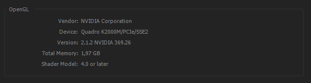

All of a sudden my GPU is not being recognized by AE - at all. Instead of my Quadro K2000M GPU, AE shows up Intel HD Graphics instead.
This is a screenshot from AE 2017 edition installed just a few minutes ago:
(the OpenGL section always displays Quadro GPU and the texture memory can be set to higher values. Weirdly, the CUDA section hasn't changed but I get terrible performance in 3D so it's probably not working as it should).
I also tried to reinstall the 2016 version, remove GPU drivers completely from the system, try to install new drivers (including standard Quadro ODE and QDF drivers - both of which didn't work); with no help.

Okay, so I've came across a fix for anybody wondering:
The issue was actually caused by a new set of drivers for my GPU. I went to C:/Nvidia and found out a few older extracted drivers from couple a months ago, so I decided to install those.
First, go to device manager, find your GPU - right click, uninstall (be sure to tick "remove software drivers").
Install older drivers
Reboot
OpenGL will now work with your GPU.
