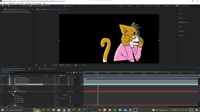

Aug 18, 2022 Aug 18, 2022
If I solo the layer I'm working with and select alpha in the bottom panel, this is what I get. Does this confirm I have an RGB channel?

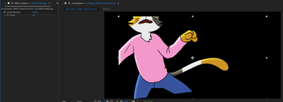

Yes, the layer style is applied correctly without Grow Bounds applied. Nothing seems to be changing the layer style itself, more so that Grow Bounds just doesn't work. (Pictures attached have layer style applied and disabled for reference. Layer has been soloed again for clarity)

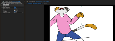

What I'm trying to do is remove the layer style artifact that shows up at the edge of the screen. After trying something with Solid Composite, it looks like Grow Bounds does work, but does not affect layer styles. Adding solid composite expanded the bounds but effectively got rid of the alpha channel.
Deleting the solid composite (or making the opacity 0%) made the layer style snap back to what it was before. It looks like grow bounds doesn't work the same way on Layer Styles for some reason
