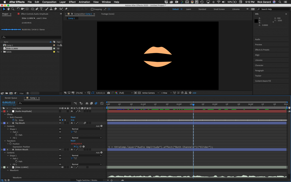

Apr 07, 2020 Apr 07, 2020
Copy link to clipboard
Copied
You have resized the screenshot so much that I can't read the error message but it looks like you just need to remove the Z part of the array in the last line because your layer is 2D.
Try this:
t = thisComp.layer("Audio Amplitude").effect("Both Channels")("Slider");
tMin = 1; //minimum Both Channels Slider value
tMax = 4.5; //maximum Both Channels Slider value
value1 = 0; // minimum starting value to output
value2 = 125; // maximum ending value to output
NewV = ease(t, tMin, tMax, value1, value2);
[value[0], value[1] - NewV]
That works just fine in this comp:
I changed the values based on the audio file used for this comp.
