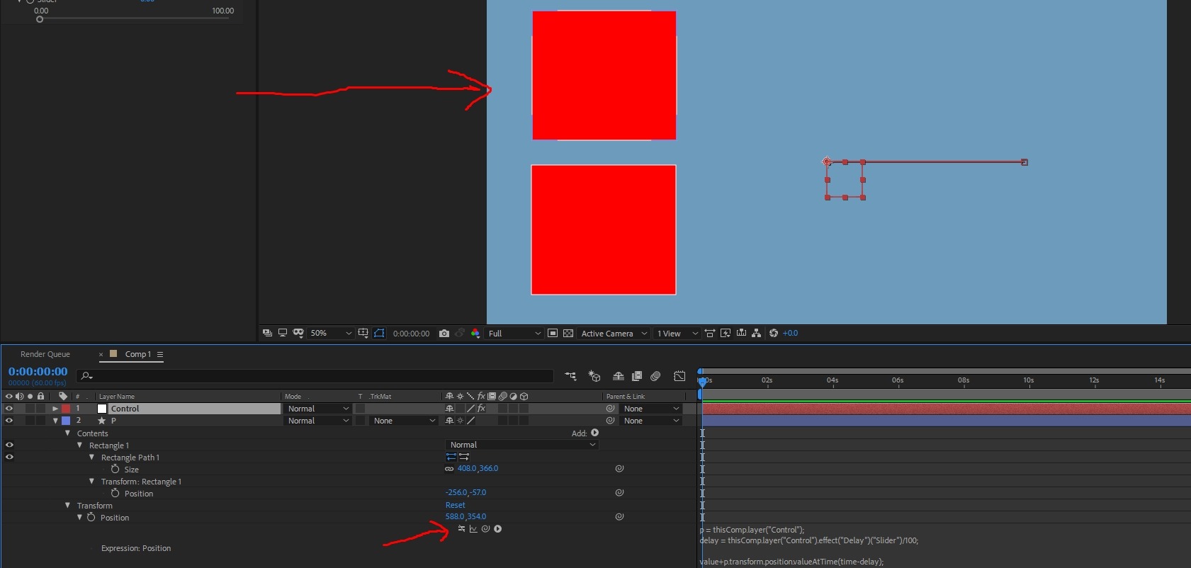

This code works but there is a kinda big problem. When i use the expression, my layer moves somewhere else and start to follow my null from that point. I create an example project to explain.
This is what happens when the expression disabled

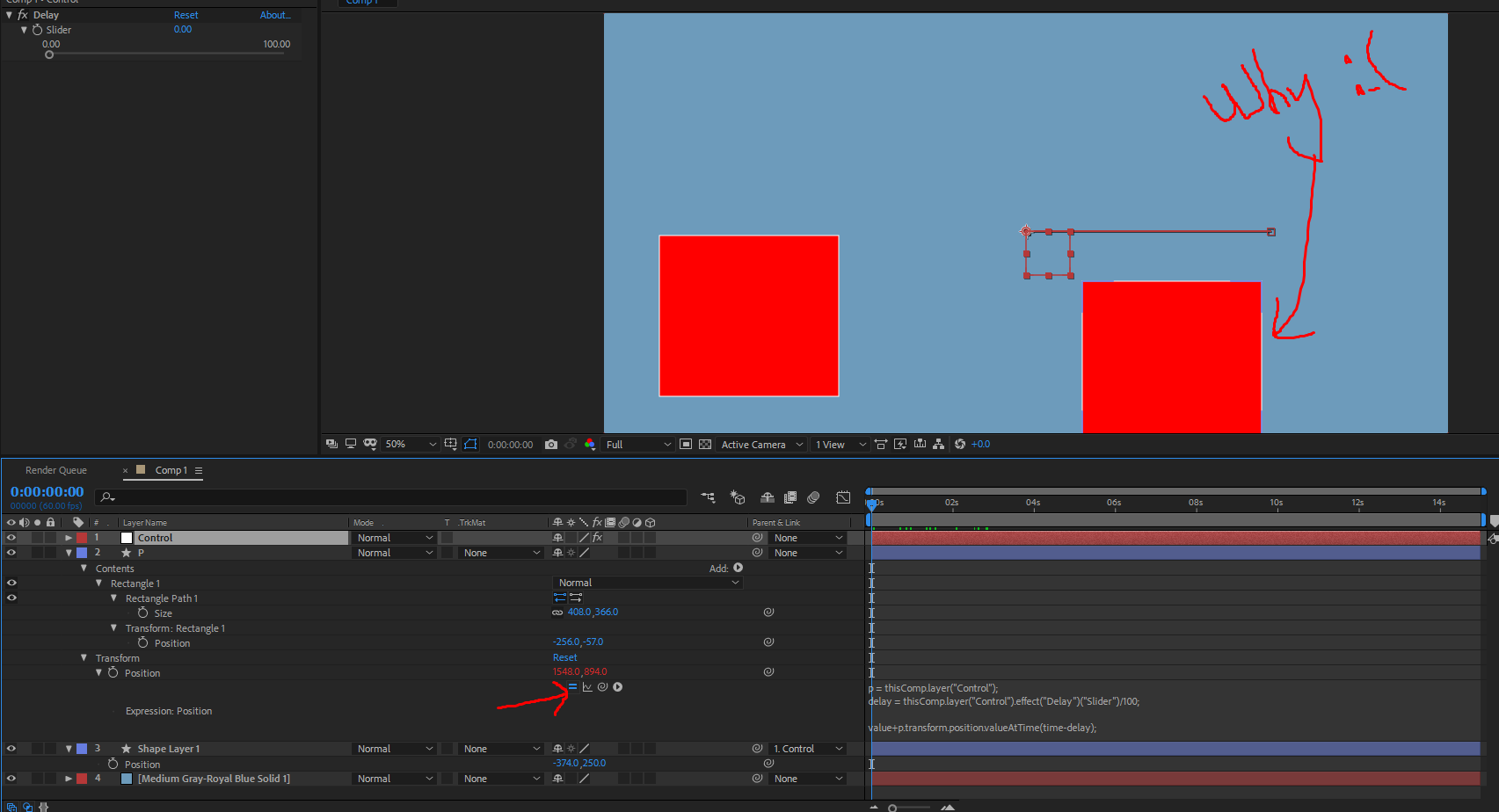

And this is what happens when the expression enabled
I am not sure how can i fix this / is it possible to fix. I hope someone can help me : D

Community Expert , Feb 20, 2019 Feb 20, 2019
See if this works closer to what you want:
p = thisComp.layer("Control").transform.position;
delay = thisComp.layer("Control").effect("Delay")("Slider")/100;
delta = p.valueAtTime(time-delay) - p.valueAtTime(0);
value+delta;
Dan

Hey Dan, that worked great : )
May i ask you about what did we wrong, what did you do to correct it?
ps. And one more small question, since slider only let me values 0-100, how can i use values more than 100?
Thank you : )
The trick is that you need to add to your follower layer's position, the amount that the control layer has moved since time zero.
For the slider, you can just right click on the value and select Edit Value, where you can enter numbers outside the slider's range, or even change the range.
Dan
