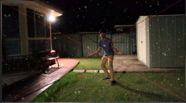

How do i remove the red guide lines in the video?

The red lines were in the video when i exported it, so im wondering how i can get rid of these? Thanks

This indicates that you used a third party plugin or effect that is in trial mode. License the plugin or remove it and the X will disappear.

Looks like an unlicensed installation of Trapcode Particular

Thanks, it partially solved my issue. Now that i installed trapcode particular (because i just had form) , the red X's now flash in a small period of time before going away for the rest of the clip. And in that scene, its a mix between form and default adobe after effects stuff.I am pretty sure i only used form though. There is an X present on this, is there anything else you think i should install to remove the red cross?

Again, you are getting the red X because one of your plugins is not licensed. License the plugin and the red X will go away.

I Just licenced everything, and now for some reason, form is now missing. WTFFFF, and here it says i already have it installed.... I tried uninstalling and reinstalling but it didnt work.

You will have to contact Red Giant. In the mess with every recent version of AE requiring updated plug-ins you may simply need to install a different version. The CS6 version would be a completely different thing from the latest CC and you may simply require to follow specific procedures to be able to use the plug-ins in both programs at any given time.
