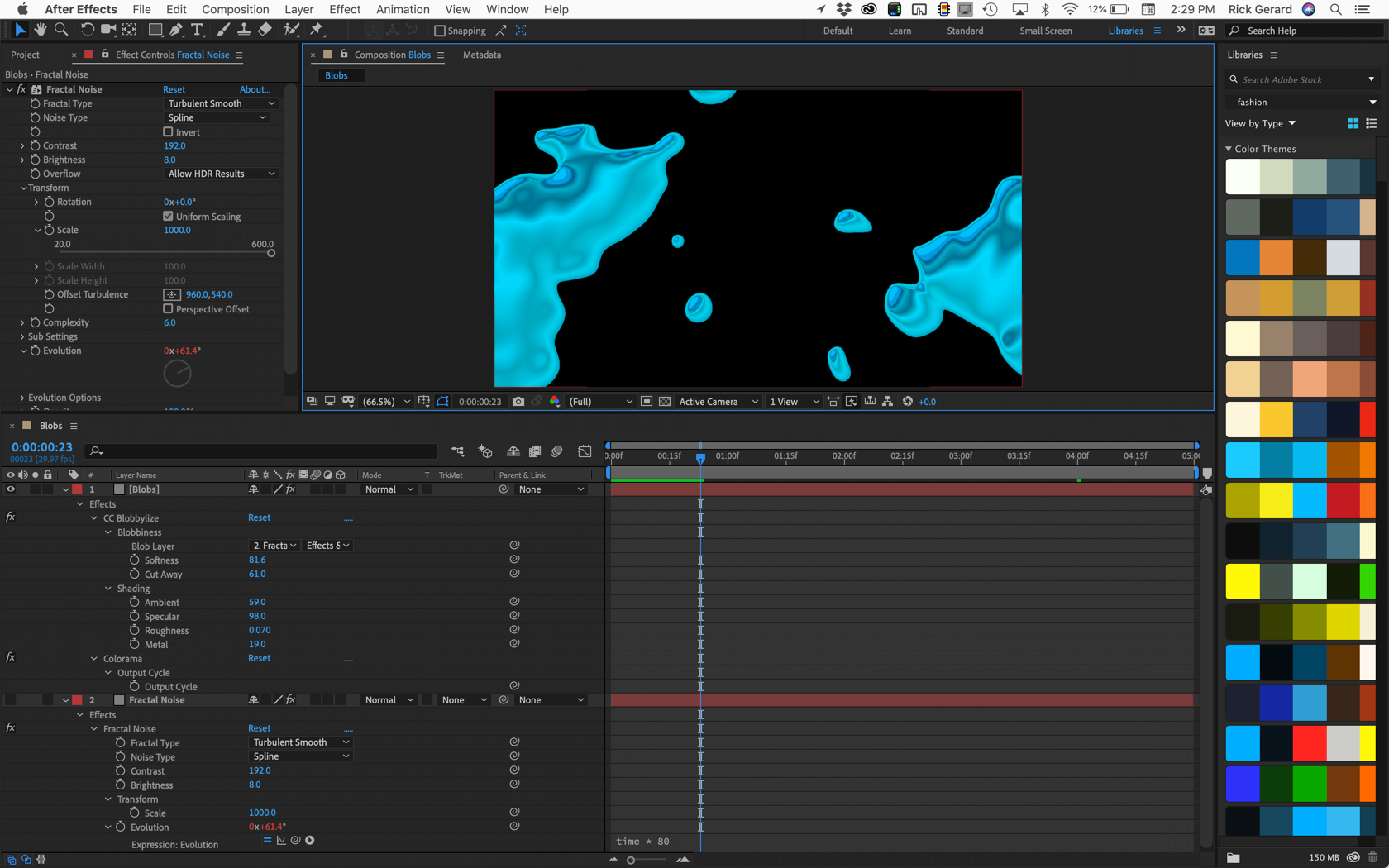

If you can get grayscale blobs you can make them just about any color using Colorama. Here's everything I did to make animated blobs:
