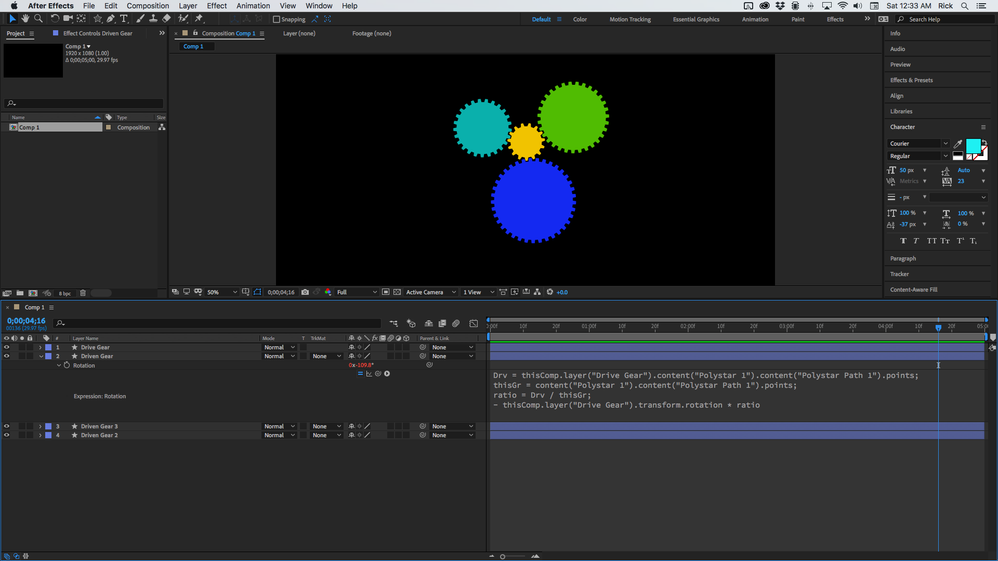

If you want to animate the image you uploaded you have to have each gear on a separate layer. You have to count the number of teeth on each gear, figure out the ratio between the number of teeth, then rotate the driven gear in the opposite direction as the drive gear using that ratio. If you make your gears using a shape layer the expression would look like this:
Drv = thisComp.layer("Drive Gear").content("Polystar 1").content("Polystar Path 1").points;
thisGr = content("Polystar 1").content("Polystar Path 1").points;
ratio = Drv / thisGr;
- thisComp.layer("Drive Gear").transform.rotation * ratio
  • The Drv variable is the number of teeth on the gear that is driving the other gear - the Drive Gear layer.
  • The shisGR variable is the number of teeth on the gear on this layer. The anchor points must be in the center of each gear.
  • If the gears do not mesh properly, and only a few of the gears in your image do mesh, then you have to use the diameter and live with gears that don't mesh.
The comp would look like this:
Here's a Project File you can look at. 
