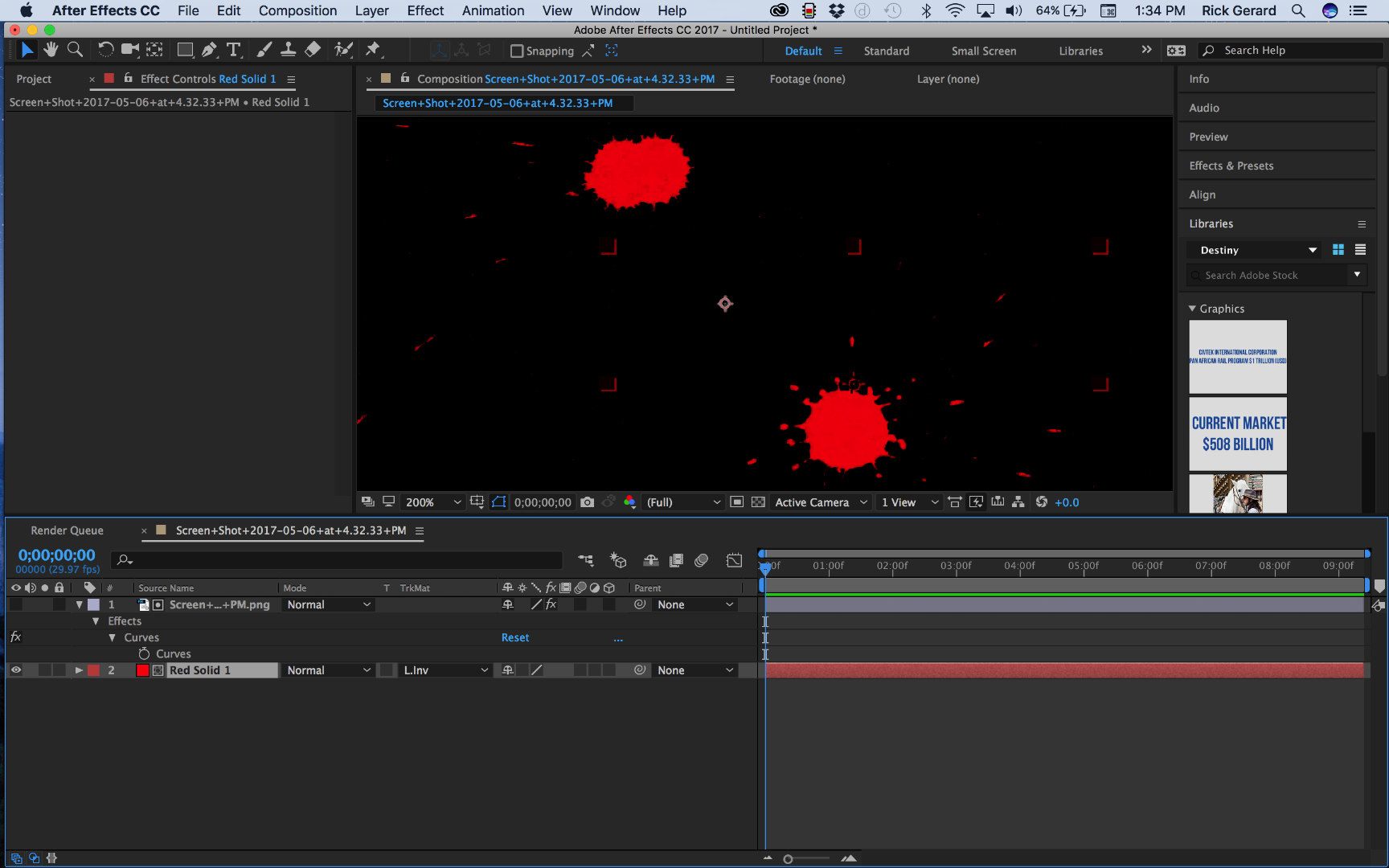

You can apply levels or curves to wipe out the detail on the gray parts. This is very basic stuff.
You could also use the layer with curves applied as a track matte for a colored solid. This would give you some more options.

I used the Keylight 1.2 option from Effects to get rid of the background
you shouldn't. keylight is for green screen or other colored screens (preferred green, blue or red). it was designed for it. you have a very contrast image so all you need to is follow Rick's procedure: set the contrast right, then use luma track matte.
