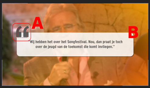

I am having a bit of an issue with expression in After Effects. I have added a image attachment to make my explanation more clear.
I made an shape layer (B in the image attachment) with a sourceReactAtTime expression. So that the shape will react to the input of the text. Now I want the quotations (A in the image attachment) always moves to the upperleft corner of the shape layer. What is the easiest way to do this?

You can write an expression that uses sourceRectAtTime on the shape layer to measure its upper left corner and place the quotes layer there.

With it you can simply create a pin for the upper left corner of the box and then parent the quotes layer to it.

If you want to do it by hand you just add values to the current position of the layer. sourceRecAtTime.width will give deliver the x size of a shape layer rectangle. You already figured that out. If you want to figure out the position of the shape layer you can just take a look at the position property. If the Transform Rectangle 1 position and anchor point are at the default 0,0 then the math is a lot easier.
All you have to do to figure out where the upper left corner of Rectangle 1 is is take half the size and width of Rectangle 1 and subtract it from the Shape layer's position. Then all you have to do is adjust the anchor point of the graphic layer to get it to end up exactly where you want it.
The expression for the Position of the Graphic layer is this simple.
s = thisComp.layer("Text Box").content("Rectangle 1").content("Rectangle Path 1").size/2;
p = thisComp.layer("Text Box").position;
p - s
I am assuming the name of the layer is Text Box. There's nothing to it.
