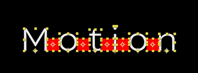

What I want is to have a pixel perfect separation distance across each letter of a word:
So, from the very side edges the distance between each letter to another must be exactly the same.
Snap to grid was my first thought but it doesn't work because you will never get both sides of a letter to touch a grid line
Any suggestions?

The built-in Align & Distribute tool doesn't provide a fixed gap setting nor will it work if your layers are sized differently. I'm also not familiar of a third part tool that provides such a solution but I will be surprised if there isn't at least one out there now.
I am actually about to complete a set of 20+ scripts and one of it does allow for a fixed gap set between layers and they can be sized differently, are child layers and theit Anchor Point can also be anywhere you choose. Below is a screen capture showing its UI and how I set it up with different sizex text characters and Anchor Points and a Fixed Gap setting.
If you want to test it, drop me a DM and we can continue from there.
