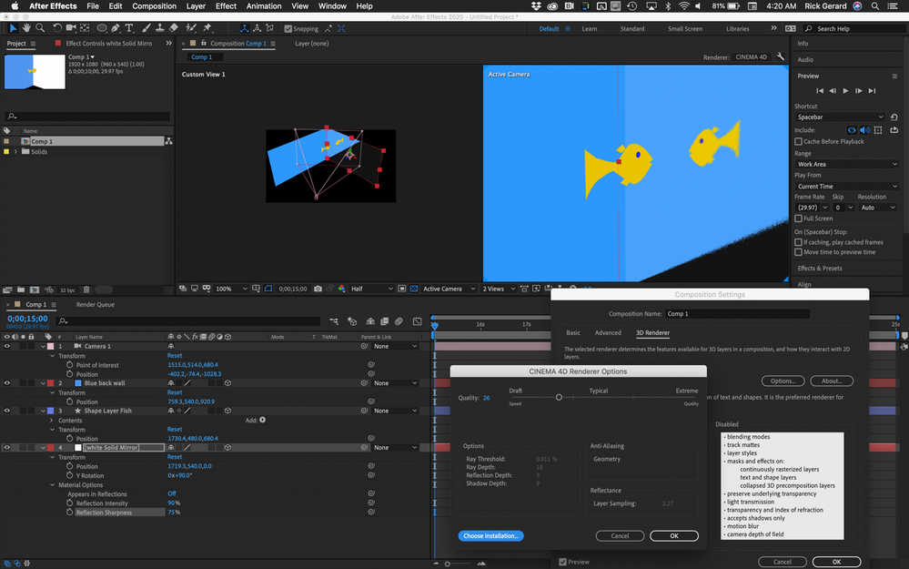

I am assuming these are 3D layers. If they are then you can set up reflections if you can deal with the sluggish performance of the C4D render engine by setting up a comp like this:
I have shown you all of the properties you have to modify. Make sure you understand the limitations of using the C4D rendering engine. You'll have to figure out how to deal with any effects and blend modes you need to sell the effect.

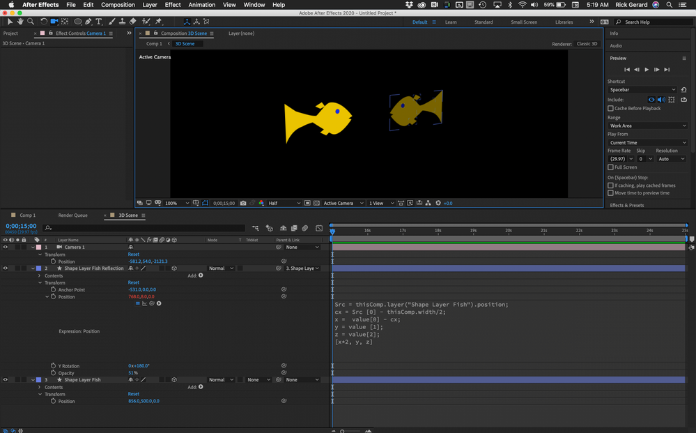

Another option would be to use Standard 3D and set up parenting and add this expression to the reflection layer copy.
src=thisComp.layer("Shape Layer Fish").position;
cx = src [0] - thisComp.width/2;
x =  value[0] - cx;
y = value [1];
z = value[2];
[x * 2, y, z]
This is what that would look like. You adjust where the reflection meets the master by manipulating the x value of the anchor point on the reflection layer. Blend modes and distortion effects will help you sell the reflection. That setup would look like this:
If your layers are 2D just delete the Z references from the expression to remove the error and scale the reflection layer by -100% in X.

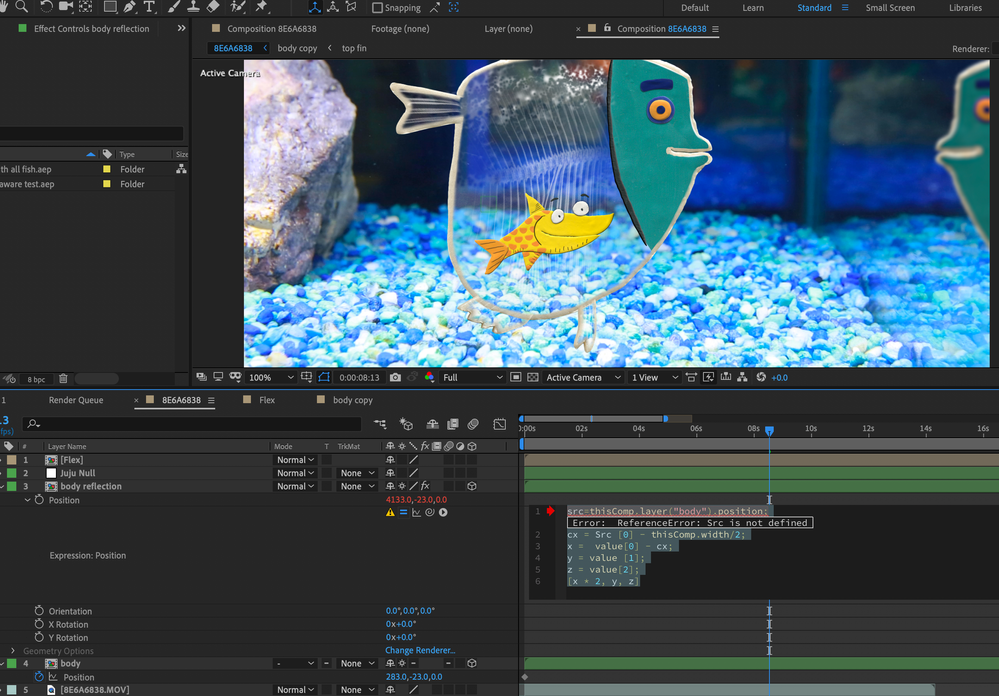

Thank you for your reply. This was not in C4D, and it wasn't a 3D layer, but I changed it from 2D to 3D to use the expression you gave me.
Do you know why it would give me the error that says "src is not defined"? The layer with the reflection is layer 3, and the source is "body" on layer 4.
Feb 24, 2020 Feb 24, 2020
I didn't say it was a C4D file, I said if you make the layers 3D then you can use the C4D rendering option to create a reflection as I did in the screenshot.

The reason you are getting the error in the expression is that there is a typo. Src should not be capitalized.
The Anchor Point on your body layer should be right on the nose of the fish.

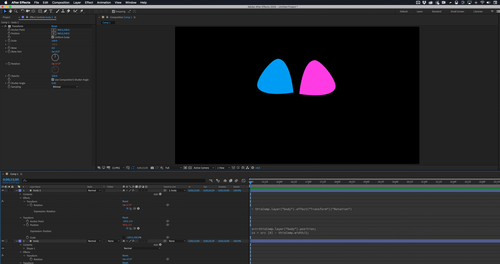

Rotation, when parented, gets awfully complicated because of the axis of rotation between the parent and child is on the parent layer's Anchor Point. If you want to animate the rotation you'll have to add the transform effect to both layers then tie the rotation of one to the other by adding a minus sign. That's by far the easiest solution:
- thisComp.layer("body").effect("Transform")("Rotation")
