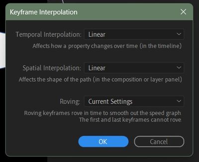

New Here ,
Oct 25, 2022 Oct 25, 2022
select your keyframes, right-click and select "Keyframe Interpolation", then choose "Linear" for both Temporal Interpolation & Spatial Interpolation.
i hope this helps 🙂
Enthusiast ,
this does not space out keyframes.
New Here ,
Sep 05, 2024 Sep 05, 2024
Hello, it's far the best advice of the topic, but i have an issues. The spatial interpolation and roving appears grey and not editable, do you know why ?
