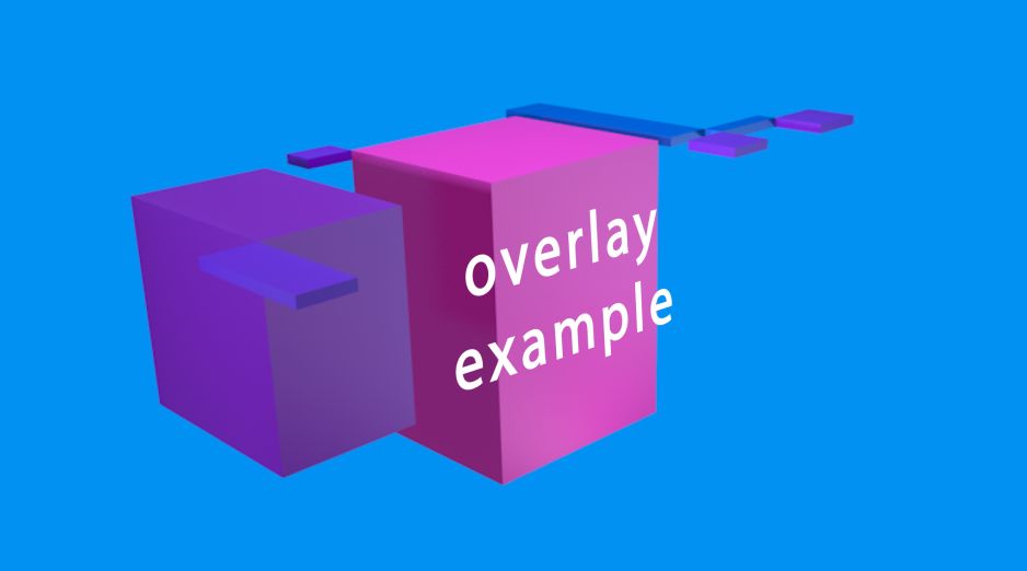

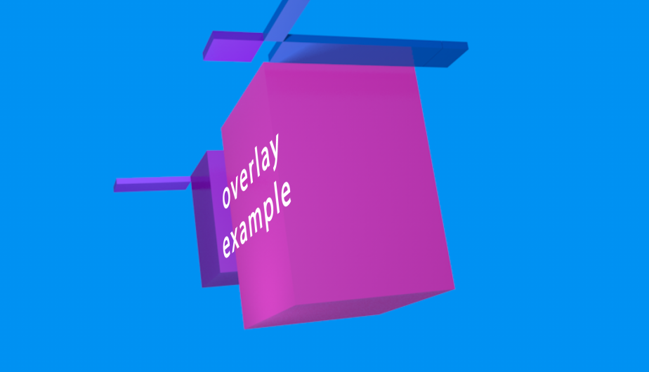

What I want to do is create comps in ae that track the 3d motion within a c4d file. In my c4d file I am using a target camera that moves along a spline and focuses on the cd objects that I have within my scene.
I want to create animations within ae that track the camera motion within my c4d file and as such appear as though they are applied to the 3d objects. In the examples below the coloured imagery is my c4d file and the white text is a placeholder example of an ae animation.
Is the best way of doing this to import the c4d file into ae and use a comp camera or to track the c4d footage? Help with this would be much appreciated as I don' have much experience with c4d
Screen Shot 2017-10-31 at 15.20.07.pngScreen Shot 2017-10-31 at 15.19.26.pngScreen Shot 2017-10-31 at 15.18.43.png

You can export the C4D camera and bring it in to AE.
This video goes over, in more detail, how to do that.
https://www.motionscience.tv/blog/virtual-cameraExport Cinema 4D Camera to After Effects! (Cinema 4D Tutorial) - YouTube
Conversely, there is a script called Paint n Stick that you may want to look in to if you do this frequently.

Thanks dj
am wondering though does the process in the tutorial only work with effects such as lens flares. For example would a shape or text within after effects rotate within the c4d scene much like the lens flares do or would they stay the same regardless of the camera rotation?
Engaged ,
Oct 31, 2017 Oct 31, 2017
It would create a 3D camera in AE that has the position/rotation data as the one in C4D. It would operate just as any AE camera and effect all 3D layers including text and shape layers.
