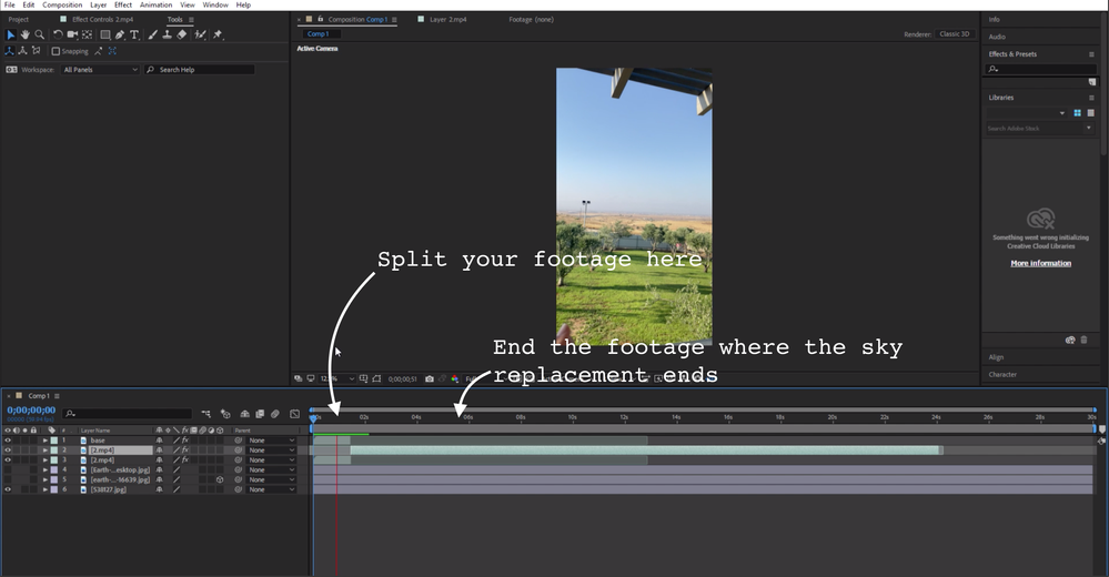

The efficient workflow for the sky replacement is to split the footage a few frames before you want to replace the sky, then split the footage again or set an out point where you want the sky replacement to end. Name the layer that begins a few frames before the sky replacement starts something like Sky Replacement, and Pre-compose the footage setting the comp length to the in and out points of the layer and moving all attributes. AE is not an editing app, it is a motion graphics and visual effects app that is designed to create shots and you don't want your comps any longer than they have to be.  Maybe this will help:
When you have done that open up the Camera Tracker and track the camera. If you do not know how to do that then check the User Guide and do not rely on YouTube tutorials by enthusiasts, most of them are pretty awful.

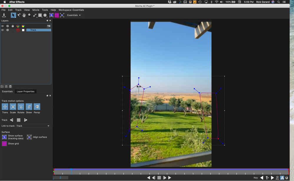

To fix the tracking problem I used Mocha AE, used two splines to select enough of the frame to get a good track like this:
The Transform data was then applied to a Null layer, the Matte layer (a copy of the footage with effects) was set to Luma inverted to remove the sky, and a night sky layer (pre-composed from a couple of images I had lying around) was put on the bottom. Transparency was animated for the track matte layer to bring in the new sky. It worked pretty well and only took about 5 or 6 minutes.
That's how to efficiently solve this production problem. If you can get a good camera track for a shot that is usually preferable, but for a basic camera pan with some wiggle where the camera doesn't change position very much, Mocha AE is probably a much better solution.
