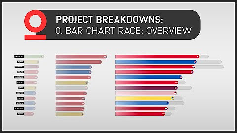

Hey, to make this clear from the start - none of these examples were created in After Effects.
However, it is possible to achieve this with a combination of expressions and scripting. The reason being why I always suggest to avoid expressions-only approach - you need to efectively compare data. The bigger data set is going to be - the slower computation becomes, up to the point where its non-bearable.
You can find initial approach of achieving these in After Effects in my Youtube channel here:
https://www.youtube.com/playlist?list=PLoAT2yyWEOrbAxaq8V8n-NxHfuXrEC3LF
Tutorial series will continue on breaking down the whole execution. Can't promise you that without any scripting knowledge you will be able to pull this through, but at least basic understanding will get you into successful thinking how bar chart race animation can be potentially achieved in After Effects.
By the way, in case if someone is interested - in the past I made comparison of huge data set processing: made with expressions only by parsing .json as a footage, and achieving the same result though scripting. It resulted in SEVEN TIMES faster rendering speeds. For one time project - its definitely might be not worth learning scripting. But for anything dynamic, and re-usable long term - using expressions-only is a massive waste of resources. If the speed is essential - then consider scripting as your main path.
