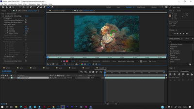

I have a comp with 2 identical layers.
Layer A on top and Layer B on bottom.
Can I use the rotobrush tool on Layer A (with 50% opacity and lowered the light) while being able to see Layer B ? (layer B 100% opacity with full light)
(layer B untouched by rotobrush)
I'd like to create a 'stencil' type of work flow, where I can outline rotobrush an image while checking the outline with the original below it.
Thanks for your thoughts on that.
Letty

Actually, I didn't ask the question correctly.
The reason I had 2 identical layers, is because I wanted to see the layer as I'm creating and have created the mask.
To fix this, all I did was change the mask to setting to "none"  (instead of "add") , in the comp layer settings section and now I can see the layer, as well as the new mask, all in one image.  🙂

do I understand well that you want to see another layer during the work with rotobrush? No, because the moment you're in the layer and don't have anything under it. You can use an Overlay view mode (red button with blue human under the viewport) and adjust it as you want to work comfortable.
but when you return to COmposition window, you'll se the edited layer and, under it, the second layer without any changes. Rotobrush works with layer, not with original of its content.

Thanks.  I'll just go back to the comp as you mentioned.
