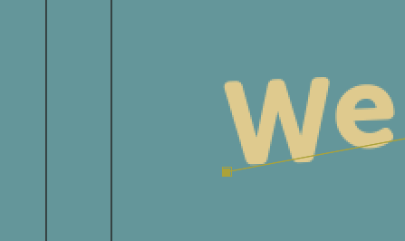

I am currently experiencing this on a text layer that has the path as a mask. It's a simple line that transitions from straight to angled. I had two keyframes with my two points initially, but now I can't get in to edit them.
When I have the mask's path selected, I see this for both points:
Whether I select that point with the selection tool, the pen tool, or any combination of those holding down control/command/shift, I can't edit that point and the text is selected instead. Like this:
I know that little circle is usually the one I can click on to edit the point, but nothing lets me click it, it only enters editing the text or resize the whole layer, even if I shrink the line width with the red handle there to get it out of the way. When I use the pen tool, and click on the point, I just get a new mask layer, or it selects the text.

I suggest you to do this:
1.- Select the Mask assigned to this layer in the timeline.
2.- Use the Selection Tool.
3.- As soon as you are near a mask point, your cursor turns into a white arrow with a white rectangle. (Check the video attached)
4.- Create a zone around the point you want to edit.

So, forgive my ignorance. I can select the point like you show, but my selection tool never seems to switch back to the black cursor until I'm clicked off the mask or path and out of editing it. Could it be a setting that I have that's not letting it switch? Holding ctrl/shift/ect doesn't seem to work, and hitting V again just keeps it as the white arrow with the white rectangle.
