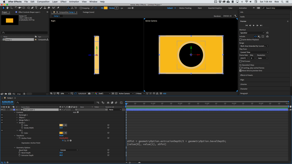

You have to compensate for both Bevel Depth and Extrusion Depth. Add this expression to the shape layer Anchor Point:
zOfst = geometryOption.extrusionDepth/2 + geometryOption.bevelDepth;
[value[0], value[1], zOfst]
I have this saved as an animation preset because I use it almost every time I extrude a layer.
