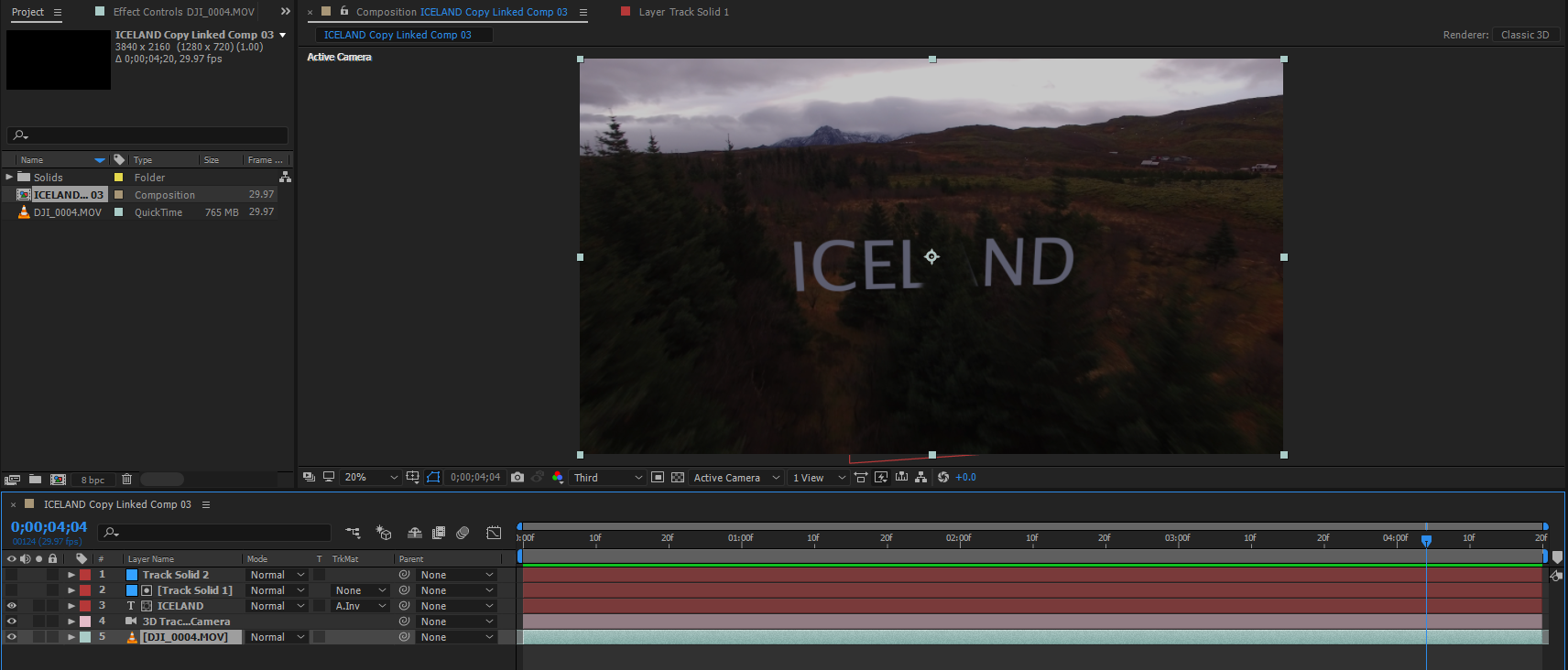

So I have a drone shot traveling backwards over some trees and the word Iceland looks like it is sitting between the trees. The good news is, I was able to get the words to go behind one of the two objects, I just could get it to only go behind one tree at a time. I can even get the track matte to switch between the two objects but never both at the same time.
Please see the attached image for reference, this will help greatly in understanding my problem I think.
Perhaps there is a better way to achieve what I am trying to do? Perhaps I do not understand how to use track mattes in the best manner? Any help would be greatly appreciated!
If you cannot read the text in the comp details in the bottom left, please let me know, I'm new here and not exactly sure what things will be most helpful to the pros to get a good understanding of how to help me with this issue.

New Here ,
Jan 26, 2017 Jan 26, 2017
When I do all of this none of the text is behind the objects anymore. See picture below.
You have to use the pre-composed matte layers as a track matte for your text.
You should study up on Track Mattes. Use the Search Help field at the top right corner of AE

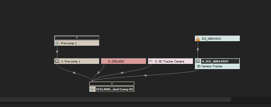

New Here ,
Actually would someone mind showing me the correct flowchart for this setup? I think this might be my problem, please see below screenshot.probs.PNG

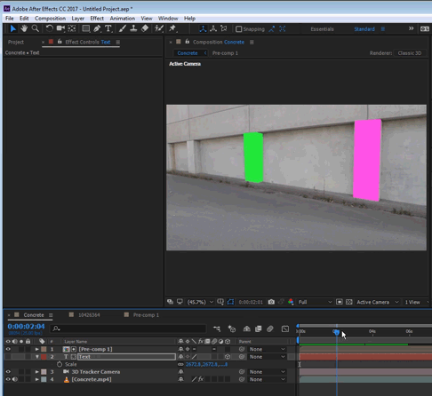

LEGEND ,
Jan 27, 2017 Jan 27, 2017
can't be sure what exactly is wrong here.
as I understand, the text is supposed to be sticking on the plane as a 3D layer and masked by different elements that are moving in the scene at different planes or points in time. so one tree here, other tree there, another tree there-  so you got different mattes on different layers but you want all of them to affect one layer.
I have created a similar setup, and it appears to work fine.
maybe you can upload the project or show us a detailed screen capture so we can better see what's the problem.
