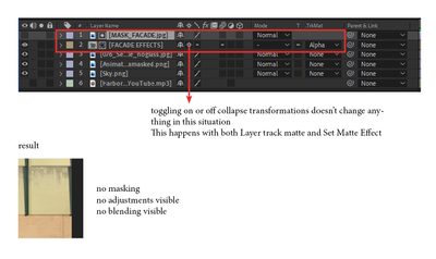

Hello everyone,
I have a big issue I have been trying to solve. mostly workflow related
I am doing a 3D animation and editing in AE woith many elements to do post-production on: facade, floor, glass, etc
For a smoother file layout and workflow I don't want thousands of layers with a set matte, so I thought to put all adjustment layers for each element on a precomp and then MASK THE PRECOMP ONLY.
Most of my layers have blending modes such as COLOR DODGE or SOFT LIGHT.
This works with perfectly with COLLAPSE TRANFORMATIONS on, UNTIL I apply the mask to limit those adjustment to the area that I want them in.
At this point I loose all blending modes and adjustments.
Is there any solution you can think of?

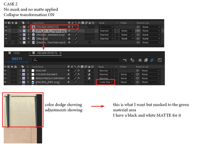

I am not working with 3D layers but just jpgs rendered form 3DS max.
Here is a better explanation of my issue that hopefully can give you more insight:
Jun 12, 2020 Jun 12, 2020
Your cropped screenshots helped a bit. An expanded flow chart would help more. I see 3 adjustment layers in the Facade Effects comp, all blend modes appear to be normal. There is really no need to have 3 adjustment layers on top of each other, even if all three of them have different masks.
I don't see any 3D layers and I only see a PNG layer in the Facade Effects comp so the only reason I can think of to collapse transformations in the nested comp would be to use the Color Dodge blend mode in Layer 4.
I see that the nested comp has motion blur applied to the layer but I don't see motion blur on any layer in the Facade Effect comp.  I'm assuming it is animated in the Main comp.
Without knowing more about the structure of your comp I would think that all you need to do to make the project work would be to get rid of the adjustment layers in the Facade Effects comp, stack all of the effects and any masks that may have been in the adjustment layers right in the nested comp and use compositing options with the masks to make the color adjustments you need to the nested comp.
