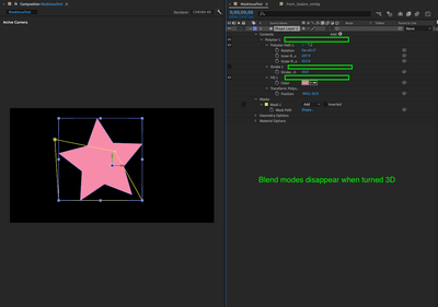

Seriously, I left it fine a month ago, and suddenly its a wreck!Screen Shot 2020-10-07 at 6.43.16 PM.pngScreen Shot 2020-10-07 at 6.43.25 PM.png

Your cropped screenshots do not show us anything.
Select the layer with the mask, press 'uu' to reveal all modified properties, take a screenshot of the entire UI including the timeline showing everything on the layer. Make sure that the comp is selected in the Project Panel so we can see the settings and make sure that the switches and modes columns are both visible by selecting the first two icons at the bottom of the timeline.
There's about a 90% chance this is a user error that will be obvious when you reveal the modified properties of the layer giving you problems.

I downloaded the file from Szalam and I had no issue with the mask, but continued to have the issue with my file and when I created a new file.
Here are screen shots of it again.
Screen Shot 2020-10-09 at 7.24.34 PM.pngScreen Shot 2020-10-09 at 7.24.45 PM.png
(I did the UU thing, but the timeline doesn't really exist. It is only 1 frame long.)
Somehow the bland mode disappear when I make the layer 3D .... which does NOT happen in the file from Szalam so I think that is the issue, but I don't know why it is happening.
Litterally nothing else is changed, but this is an extreemly frustrating glitch that has popped into my AE.

You lose masks and effects along with blend modes when you use the C4D rendering engine. The complete list of things that go away is shown when you enable that rendering engine. Go back to the Classic 3D rendering engine and all of the missing properties come back.

I know you said earlier that your renderer was set to classic 3d and not the Cinema 4D renderer, but your screenshot shows that is IS, in fact, using the Cinema 4D renderer. As Rick said (and @Jose Panadero in the very first post was calling out), you need to change to the classic renderer.
