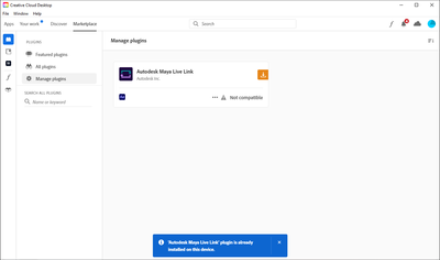

Has anyone figured this out. It sucks that I was able to use this, until I updated to AE 2021 and now nothing. It shows as installed on the machine but not available as an extension inside AE. When I'm in the cloud desktop it just says Not compatible. ZXP installer doesnt work, Extension Manager doesnt work. How do we fix this? I dont want to have 2 versions of AE on my machine just so I can use this.

I was able to get this loaded into AE however it did not work. I had been trying to find a solution and Im happy to say I found one. Anyone looking to get this LiveLink working with (I HAVE THIS WORKING AND CONFIRMED) with Maya 2023 and AE 2022 Screen shots attached. Click the link below and look for @misha123 there is a client.py file on the post. Download and overwrite the file in this folder
Maya2022/plug-ins/MASH/scripts/MayaToAE/client.py
I have been using this with no issue, and it also fixed earlier versions of Maya LiveLink and AE
