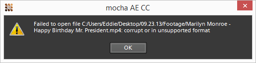

Hallo,
I used usually mocha and it worked perfekt, but today I was trying import a video and it say "failed to open file ***.avi: currupt or in unsupported format" the same message it say with mp4 format.
What can I do? avi and mp4 formats are support formats.

Not all video formats are currently supported by mocha AE. Imagineer is working to resolve this, but currently if you clip does not open in mocha AE, we recomend transcoding it to another format. This tech note may help: http://www.imagineersystems.com/support/Documentation/supported-file-formats#idp19920
In the rare event that you are working in a format that mocha doesn't support, we recommend converting the footage to an image sequence.
If you are just tracking, you can use any compressed format such as a JPG sequence and then use your original footage when you apply the data. If you are going to be doing rendering, such as using Mocha Pro's remove or insert modules, then we recommend converting to a DPX or TIFF sequence.
Make sure of the following when converting to an image sequence:
If you would prefer to convert to a movie clip format then we recommend a standard format that QuickTime would understand, such as Animation. If you are working on OSX, ProRes can also be a good alternative.

It is possible that Quicktime is causing this issue. Please contact Imagineer support to get more detailed support:
Copy link to clipboard
Copied
i changed to qt 7.5 and everything all right:) After instal qt reboot pc:)thats all

I have a desktop computer and just got a new laptop, both running Windows 8.1 with all updates. I am subscribed to Adobe cloud, so I have the exact same versions of AE on both (and, I would assume, the exact same versions of Mocha). I have the same version of Quicktime installed on both. The exact same .mov file, loaded from an SD card (so it's definitely the SAME file) loaded into AE and then tracked in Mocha works fine on my desktop, but says it is an unsupported file on my laptop (in Mocha -- it plays fine in AE on both systems as well it should).
What the @#$%!@!? How can the exact same file, working on what we would presume is the exact same system, work in one and not in the other? Is Mocha brain dead or something? I assume it has something to do with some video codecs that are different on the two systems, but in point of fact Mocha shouldn't care, not for an .MOV file (which should be loaded in via the QT codecs, I would assume). I don't really have any way of determining what other codecs are available on my desktop that are not on my laptop, but I really shouldn't have to do so -- no other piece of software really cares (IOW, I can load up this .MOV file in ANYTHING else and it works just fine -- just not in Mocha on this laptop).
Anyone have a clue? Because Mocha sure doesn't.

Hey Mike (and others!), sorry to see you're getting format issues with QuickTime files.
For those still having trouble opening movie files on recent versions of mocha AE, can you tell me if you have the BlackMagic codec installed? We recently discovered a defect that would show problems with this codec causing a conflict.

We've written on the Creative Cow forums about this, but for the benefit of others this might help let me summarize that my problem was finally solved by simply rebooting my laptop (which I had been shutting down by closing the lid and NOT rebooting).
I had installed Quicktime (the latest version) and it was working fine in AE otherwise, but Mocha still would not load in any .MOV files (even the ones that were now playing correctly in AE). After a reboot all was well.
I realize some software, particularly things that write to tables or startup memory, requires a reboot, but Quicktime did not say this and none of the other programs I used to test the .MOV file had an issue after it was installed, including AE (which gives you a warning if QT is not installed). It was only Mocha that required the reboot. and that threw me off.
I realize that's a fairly isolated and specific case, but if it could even help one additional person with this issue it would be nice to have it documented somewhere (for most folks the problem will "fix itself" the next day, after they've shut their computer down. "Hey, I could have SWORN I had a problem reading this file!" :>)

I've had this issue twice now at random times, what resolved it for me was downloading QuickTime 7.5.5
Copied
Agree. Just install Quicktime. I don't know why that works but it does.
