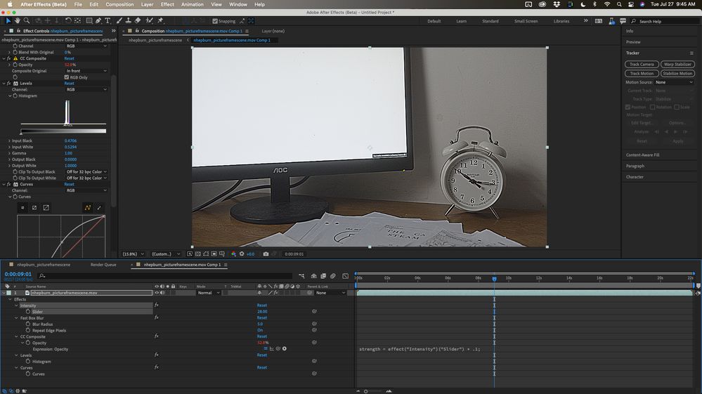

On the color grade, I have no set standard workflow. When I'm color grading for tracking I often do some strange things to the video that look like this:
When the tracking is done I remove the effects. Then I color grade the final composite to match the edit or the client's requirements.

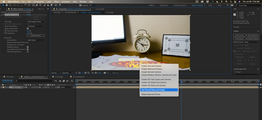

I took a look at the footage you gave me and created a comp to try and figure out the best tracking solution. I'll give you an overview of my workflow and share a file at the end that uses the footage you supplied.
Step 1: Create a comp from the trimmed footage you supplied, added an adjustment layer and color corrected using Lumetri to give me the best color and most detail that I could get from the shot. The reason for the color correction is to provide as much information as possible in my 32-bit project.
Step 2: Pre-compose to create nested comp that I could use for Motion Tracking naming the pre-comp Nested Footage.
Step 3: To provide a comp for testing the tracking and figure out the best method I duplicated the master comp, named the copy Test comp, reset the composition frame size to 1080 X 1920, scaled the CC footage layer (nested comp) to fit horizontally, pre-composed the CC footage comp and named the new comp for Tracking Test comp. If I do not collapse transformations this gives me a much smaller frame size to experiment with the tracking methods that will analyze, track, and render faster.
Step 4: I ran tests with Mocha AE and Camera Tracker. There is just not enough edge detail in the Monitor that is on the left to get a good track. If you had put up any kind of an image with some detail on the monitor screen. If you were using the monitor for a light source you needed some detail on the monitor frame that could be tracked. Not just tracking markers, but something like a checkerboard patterned tape on the edges that could be easily tracked and replaced.  Mocha also had some problems with the Picture frame on the right side of the frame. They were not as bad, but Mocha was not going to be a good solution to this shot because of the lack of detail in the monitor and the edges of the picture frame.
Camera tracking worked much better if I turned on Detailed Analysis in the Advanced section. I got a tracking average error of about 1.25 pixels. Now it is time to Camera Track the full resolution copy. The total time so far is about 20 minutes.
Step 4: Camera Track the main full resolution comp. This is self-explanatory. I just turned on Advanced analysis, made sure that the process had started the track. On my basic M1 Mac Mini I'm using for testing right now the estimate for the tracking to complete was about 40 minutes. It's about what I expected from this 6K footage. I had dinner and came back to the project to set up the camera and some track solids.
Step 5: Establish an origin and ground plane. I picked a time where I had a decent number of trackers on the desktop, set a layer marker, then established an origin and ground plane when the selection I drew around the trackers looked correct.
I added a camera and solid using the same tracker selection. A little rotation and scaling of the Track Solid completed this part of the project.  I added the Grid effect and checked the track. It was good.
Step 6: I then selected track points on the monitor. There were not very many, and I could not get the target to line up with the surface very well, but I could adjust orientation later, add a grid,  scale and use the multiply blend mode to get the grid to line up with the monitor frame precisely, then check to see if I got it right. This is the most frustrating and time-consuming part of the project. On the second try, I got everything lined up and the track appeared to be good.
Step 7: Repeated the process for the clock and the picture frame. The clock was the easiest, the surface was perfectly aligned the first time. The picture frame was easier than the monitor but it still required manipulation of the orientation and some scaling to make it work.
Step 8: Add some footage for the picture frame to the comp, make the footage layer 3D, then shift + parent the footage to the picture frame to snap it into the same position orientation and scale. The footage was then scaled to match the picture frame.
Step 9: Enable time remapping on the replacement footage, pick a frame that I wanted to freeze and set a new time remapping keyframe, delete the first time remapping keyframe, then select Time remapping to select all time remapping keyframes and grab the first keyframe in the timeline and slide it down the comp to pick a place where the picture turns into the movie.
Step 10: Set up the push-in on the picture frame. Because perspective is controlled by camera position and framing by focal length you want to animate the zoom value (press aa with the camera selected) and scale on the replacement footage. If you need to reframe the shot as you zoom in you also can animate the orientation and rotation of the camera. I picked a point where I wanted to start the push-in and set a keyframe for scale on the replacement footage and zoom on the camera, then I moved down the timeline and adjusted both values to carefully match up the shot. I had adjusted the grid on the tracker solid for the picture frame so that the grid was perfectly lined up with the markers in the picture frame. This is what that looked like:
This is the result so far:
Sorry about the small size and low frame rate of the gif but you get the idea.
All that is left is to set the tracker solids to guide layers, replace the footage on the screen. add some reflections to the replaced footage by matching the new footage on 3D layers using Shift + Parent in the same way that the footage was matched up to the picture frame.
When all of that is done I would also set the footage layer (Layer 7 "CC for Tracking") as a guide layer, then render a Lossless with Alpha copy of this footage that you could overlay in the final edit. That way you have complete control over the color correction on the original footage and on the overlays. I might even consider rendering a computer screen overlay and Picture frame overlay separately. For most of my clients, those renders would be EXR sequences or ProRez 444.
The total time on the project was just over an hour and a half. Here's my sample comp for you to take a look at
I hope this helps. This would be a good project for a tutorial. Especially good if you shot the same original footage two ways. One with more detail in the shot and one the way you did.
