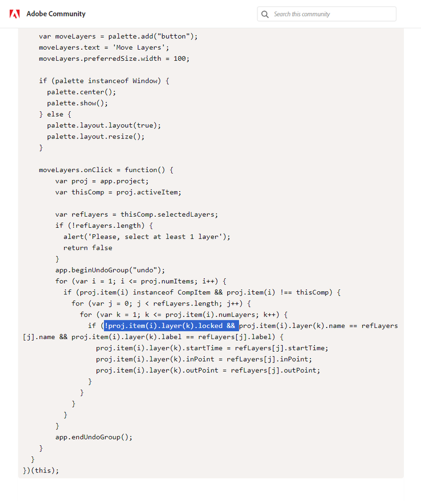

Is there any way to get this script only move layers that are not locked (not a lock-icon in after effects) ?
Advocate ,
Feb 28, 2024 Feb 28, 2024
I updated the code.
