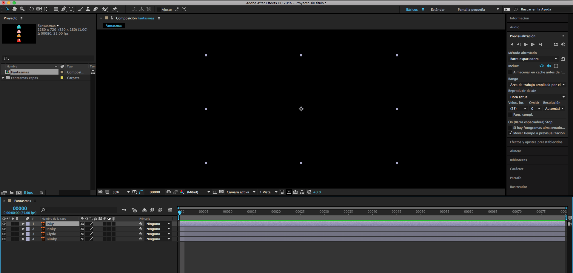

Hi.
I use Adobe CC 2015 in a Mac with OS High Sierra.
The problem I have: composition window in after effects doesn't work. The whole area is black. I can still do everything, make new layers, place images, select them but I can´t actually see what I'm doing.. I hope the picture below will give you a better idea of what this problem looks like.
I have no idea what happened, it wasn´t like this before. I don´t know if it has something to  do with the new OS (High Sierra).
I'd really appreciate any advice   Thanks!

I just create a new composition, there are no pre-comps. There is only the main composition "Fantasmas" (Ghosts  in spanish). There are 4 layers the are visible. As you can see I have the Inky layer selected but is black in the Composition window.

The opacity of the layers are at 100%. I change the background color to green but the Composition window is still black. Check the image below.
I´m using a Mac so I can´t update the video card drive, right? That´s for Windows.

Thanks for the advice, I did everything but the Composition window is still black. The layer wasn´t modified because it was a new project, I press U twice and nothing happened.
I already clear the cache and reset the preferences of After Effects and the window is still black.
My ghosts were made in Illustrator in RGB mode.
Maybe CC 2015 isn´t compatible with High Sierra?

May 16, 2020 May 16, 2020
Hey!!! This is a pretty simple fix..at least I just figured it out myself.
On your new comp at the top left you'll see 3 lines on the right of it. Click that and there should be an option for "Transparency Grid"
That fixed it immedietly for me. Hope this helps!
