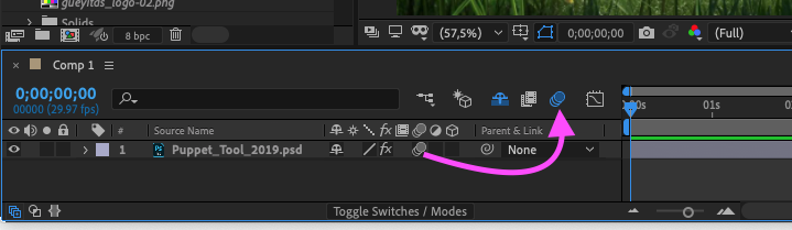

you must also activate the motion blur from composition timeline, so did you click this button?
Also you must have some object in action (move, rotate, scale...) to be able to see the motion blur, so if you want to apply a motion blur on a footage, it's a different story, and in this case you can use the CC force motion blur and if you don't see any result try to increase the shutter angle value as much as you need.

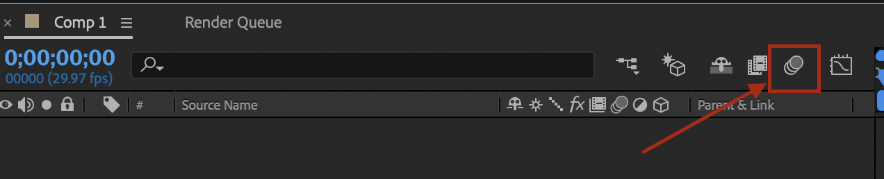

Remember that to be able to visualize the motion blur you need two actions: activate the Motion Blur in the Layer and activate it in the Timeline, both must be activated, otherwise it will not help you if you activate only one.
