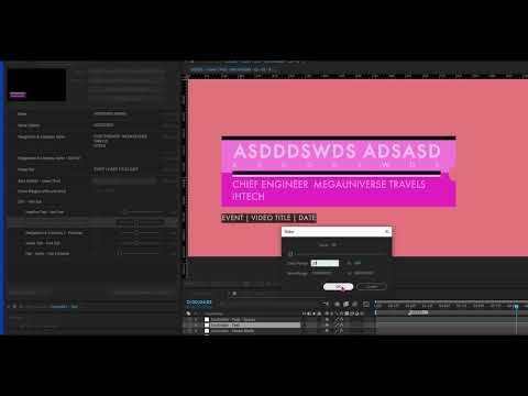

And this sample shows a complex lower third - This set up uses about 60+ Expressions within a single composition.
https://youtu.be/8h6pwdQJWQA
This set up uses the latest Text Styling which allows multiple fonts per Text Layer. The Expression to the Source Text property is over 500 + lines. It's still performan but what I want to share is that working with Text is really complex and when you want to get pixel-perfect and have multiple text layers and shapes working in unison, you are dealing with a somplex solution.
