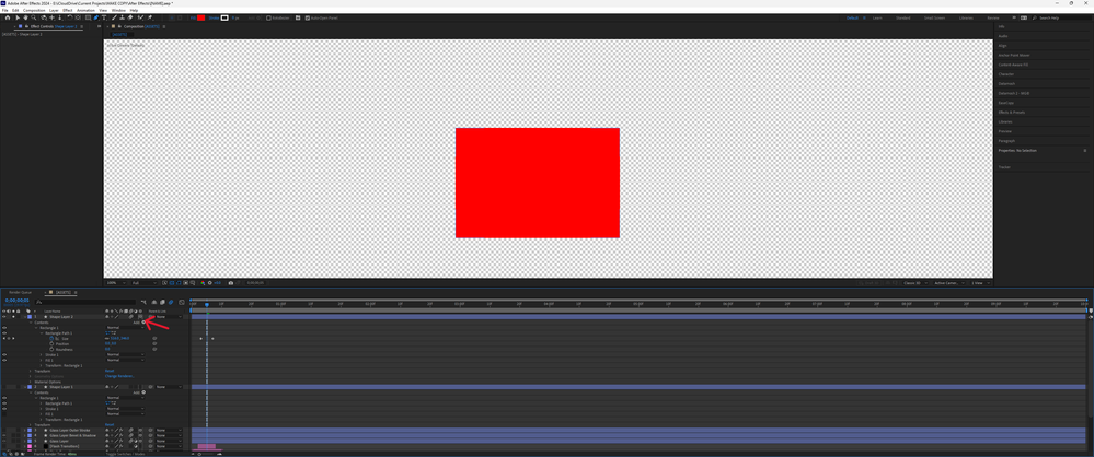

I have a rectangle. And I have animated the "Size" property under "Rectangle Path 1", very basic. You can see it in the pictures. I also have enabled motion blur which works all fine but just as long as the layer is a 2D layer. As soon as I click the 3D icon on the layer the motion blur is gone. I do nothing except changing the layer from 2D to 3D.
I tested the same with the "Scale" property under "Transform". There I get the motion blur both with the layer being 2D as well as 3D.
But because I want to add rounded corners to the rectangle I have to animate it with the "Size" property to not distort the round corners.
How to solve this?
Edit: I want to make the animated 3D shape layer an adjustment layer in the end. That means I can't use CC Force Motion Blur because that would affect not the shape layer but everything beneath it.
AE version: 24.2.1
OS: Windows 11    

Explorer ,
Apr 17, 2024 Apr 17, 2024
Motion blur is checked for all the layers as well as in the comp settings.
Using Classic 3D renderer.
No ray-tracing here.
I think the issue is that as soon as I turn the shape layer into an adjustment layer, the layers' bounding box becomes a mask. That means the motion blur is there but just cut off due to the shape layer ending at the edges of the shape. But that would also not explain why the layer cuts the motion blur off only when it's 3D, if that's the case it should also be cut off when it's 2D.
It might work tho if I add a mask that is bigger than the shape and set it to "Add". Will try that later.
