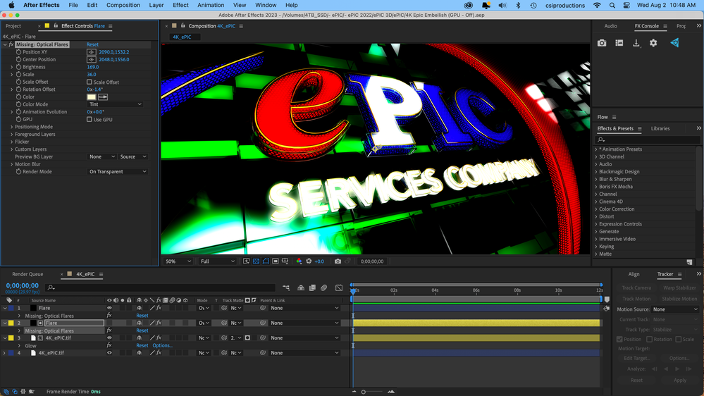

Is your system crashing or are you getting the warning that there's a missing plugin? Mine is the later. Did everything suggested by VideoCopilot and still not working.
Suggestions to go back to a previous version is fine with a new project but most of my material is set up as templates for banging out the same material for a multitude of users and with files not being backward compatible, that doesn't address the issue. Dead in the water with respect to Optical Flares at this point.

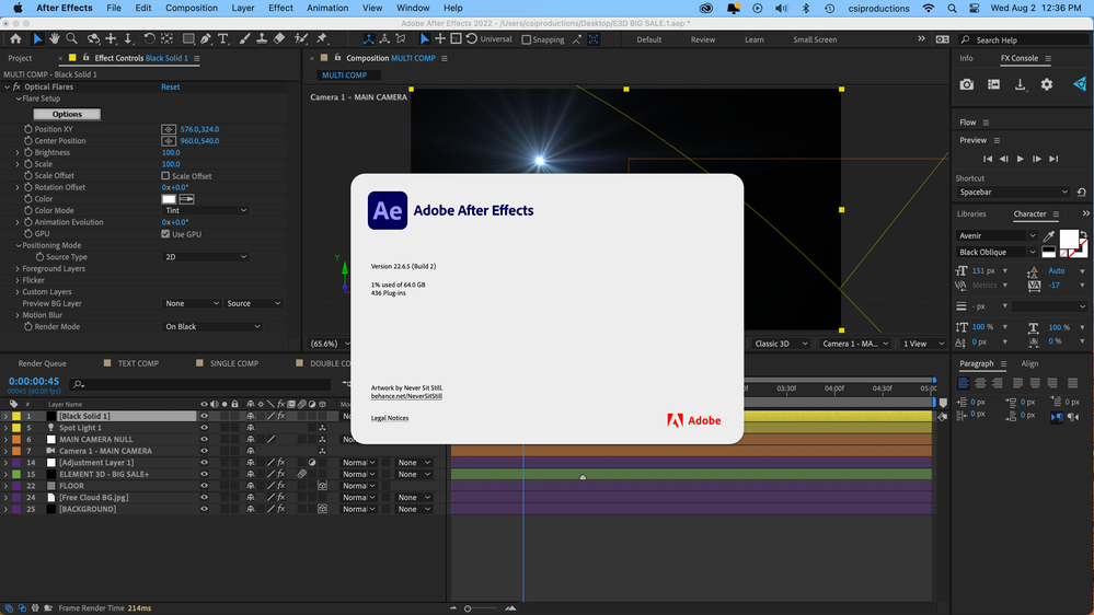

Aug 23, 2023 Aug 23, 2023
While making sure the software version, the plugin version, and the operating system are all compatible is important, anything else running in the foreground or background can affect things.  Do you remember the Mac OS fax extension that caused all source footage in After Effects to show as 0-by-0 pixel until it was disabled?  It made no sense what so ever.  This was 1996… Mac OS 7.6, After Effects 3,  before the successful After Effectss version 4 port to Windows.
Optic Flares is working expected with After Effects 23.6 on my Macs (Intel and Apple Silicon) and my Windows 11 laptop.  If I had an issue going on this long, I definitely would have tried a clean macOS, clean After Effects and clean Optical Flares on an external boot drive by now - especially with how easy it is to do with an Intel-based Mac.

I'm using VC OF 1.3.8 with iMac AE 23.5.0 and the file with a flare applied opens but with a warning that a plugin is not installed - but it is.Missing Plugin.pngOF Installed.png

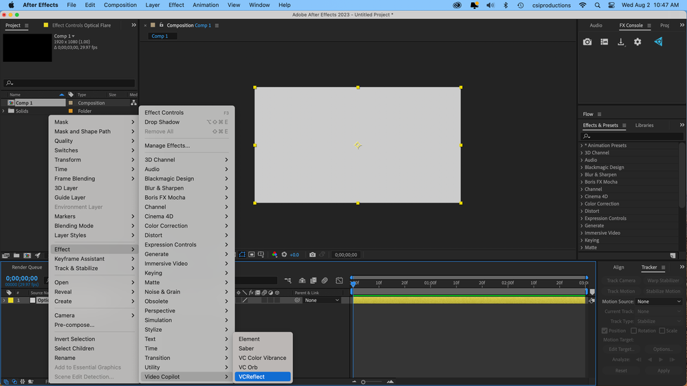

First just to be clear, I'm not the one whose system is crashing when trying to open an Ae file with Optical Flares. Mine opens but I get a warning the Plugin is not installed (attachement above). I attached a screen grab showing the plugin is in fact installed and I've attached two more screen grabs showing a new Ae file I tried applying OF to and it isn't showing in the VideoCopilot menu. An additional screen grab is the same as another I posted above ( a previous file with OF applied) and it say's the file is missing.
I've been trying to resolve this with VideoCopilot Support (Matt) and he suggested tossing the olde installer/plugin and redownloading/installing with the new installer. That hasn't worked either. I just sent him another email pointing to this string in the event he wants to chime in.
I'm wondering if the newest OF installer is for M1 macs. Mine is a 2020 iMac and not an M1. I mentioned this and asked for an older installer to see if that resolves this.Ae not seeing the installed pluginAe not seeing the installed pluginOlder file showing plugin is missingOlder file showing plugin is missing

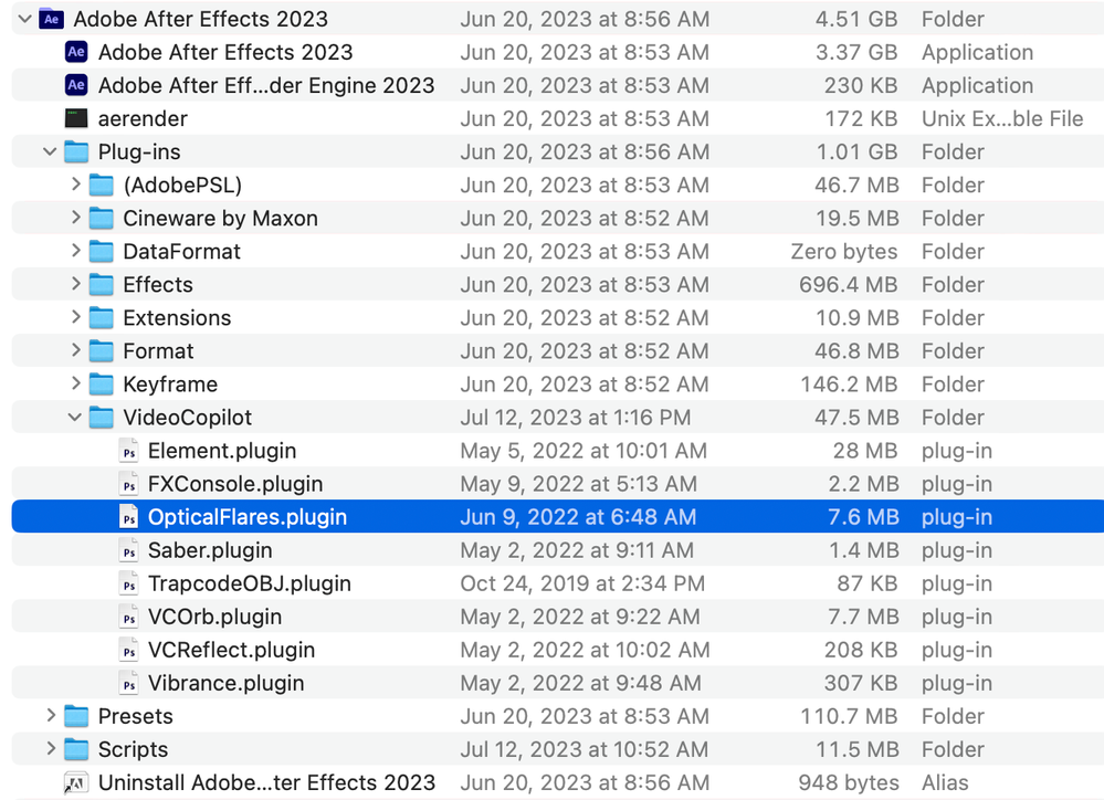

Aug 02, 2023 Aug 02, 2023
Double-check this file path:
  • /Applications/Adobe After Effects 2023/Plug-ins/VideoCopilot/OpticalFlares.plugin

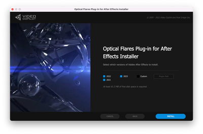

Some other things to check:
  • The installer prompts us to "Select which versions of Adobe After Effects to install".
    Video Copilot Optical Flares plug-in for After Effects Installer > Select which versions of Adobe After Effects to installVideo Copilot Optical Flares plug-in for After Effects Installer > Select which versions of Adobe After Effects to install
    Running the installer again is probably the easiest way to resolve this, but it should also work to copy it from an older After Effects plugins folder to the plugins folder of the version of After Effects being used.

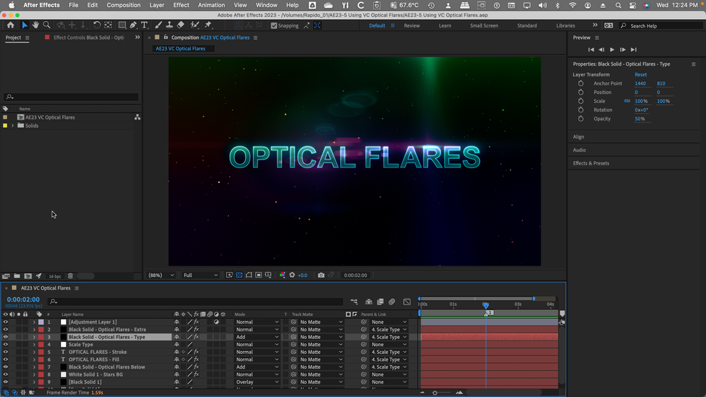

Warren, I really appreciate your dilligence with respect to troubleshooting this. I attached an image earlier in this string (today) showing my plugin being in the proper place (BTW I'm one of the original - CoSA - Ae Beta sites) so I'm hardly a newbie as to where and how to install plugins. I can normally troubleshoot these things my self but this one is trickier than most. So! the plugin is in the right location.
I'm attaching a screenshot showing that the 1.3.8 OF plugin is working in the 2022 Ae so my suspicion (like the other person on the PC) is that Ae 2023 is the challenge. As suggested, I just copied the Plugin from the Ae 2022 Plugins directory to the 2023, started a new project and like the the screen shot I posted ealier, Ae isn't even seeing that specific plugin in the Effects/VideoCopilot menu. Every time I've ever upgraded Ae or OF it's worked without all the suggestions you've made.
I could see if I was loading it for the first time how those suggestions might come into play but for over two years I've been updating Ae and my OS and never had to do anything other than maybe re enter my VideoCopilot serial number.

TY. I neglected to post the plugin working in Ae 2022 but it looks like you've exhausted your ideas - understandable, this one has us both stumped apparently. Good to speak with another long timer. Love the program just have to figure out what's happening here. I plan on updating the OS this evening but I'm not confident that's it. Thanks for all the time you spent on this.Screenshot 2023-08-02 at 12.36.46 PM.png
