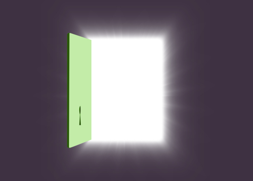

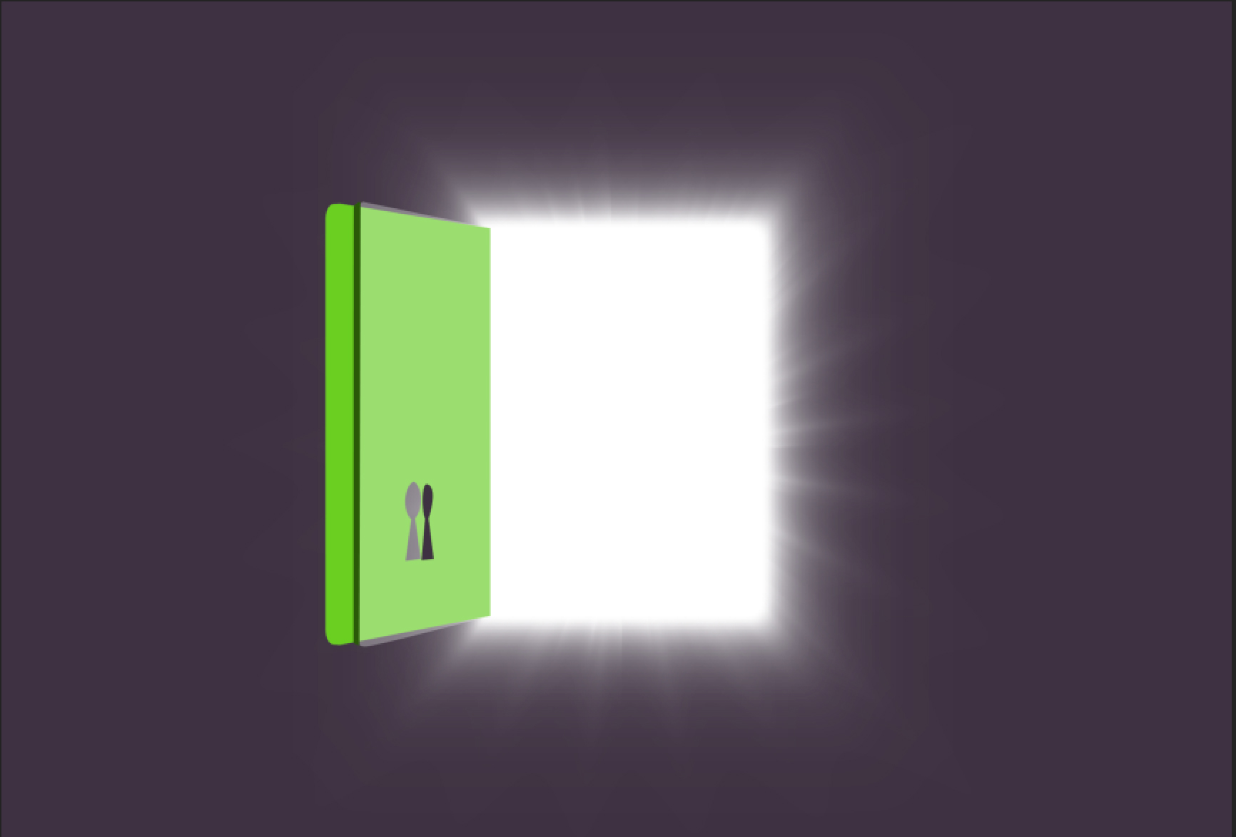

When I work with all layers, the timing/easing is fine. As soon as I pre comp the layers, they seem to shift in time or possibly the easing goes off slightly.
Any suggestions?

Explorer ,
Dec 03, 2018 Dec 03, 2018
Having this selected definitely changes something, it doesn't fix it though, just kind of shuffles the layers round a little more. I've noticed when I move the comp around the 3d layers are reacting/moving independently as if the pivot point is moving within the comp – if that makes any sense. I presumed that when I pre comp layers, if I move the comp it won't effect the layers within it?
Sorry if I'm not explaining it all very well...

Explorer ,
Within the comp it's always fine, but when I drag that pre comp into a new comp with different comp dimensions and scale the comp down/up it throws the layers out of sync...
