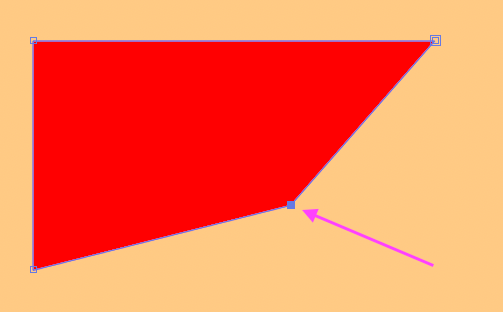

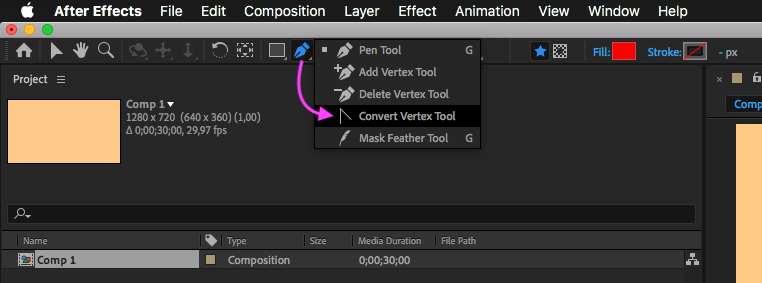

Jan 20, 2021 Jan 20, 2021
Try this:
Create the shape while holding down the Alt key.
Then choose the Convert Vertex Tool.
Now move the point you need by holding down the Cmd key on Mac or Ctrl on Windows.
Convert Vertex ToolConvert Vertex Tool
Move the point you needMove the point you need

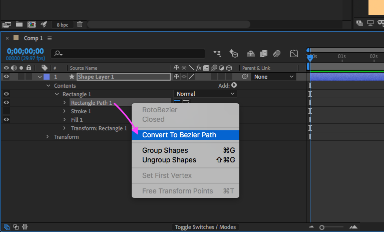

If you already have the shape created, right click on the content of the Shape Layer / Convert To Bezier Path, then select the Convert Vertex Tool and you know the rest.
Right clic / Convert To Bezier PathRight clic / Convert To Bezier Path
