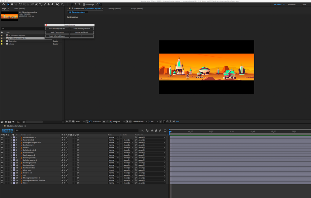

I have a 2560 x 720 composition in which all of my 3D layers are positioned to my liking:
I need to resize this composition to 1280 x 720, but when I do so, my layers don't keep their assigned positions.

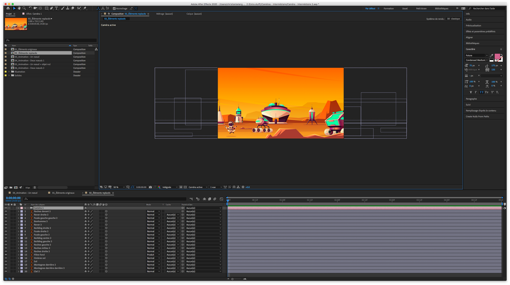

I create a new camera:
So far, so good:

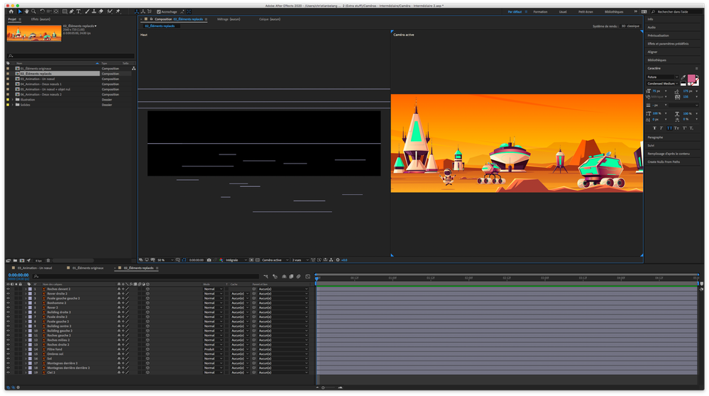

But when I resize the composition, THIS happens:

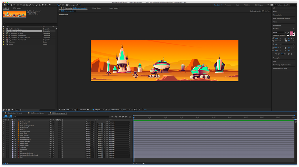

The problem is, I need the composition to crop from the left in order to get that result:
But obviously, when I reposition my elements or my camera, everything shifts!
So how do I resize my composition from the left while keeping all of my elements in place?

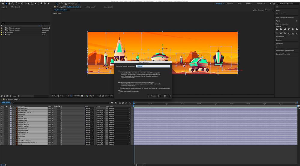

Here is what happens with the first option.
I do the precomposition:
I create a new composition:
I put the precomposition in the new composition and position it the way I want:
I hit the 3D icon and the collapse transformations icon, and everything shifts:
I tried to correct the situation with a camera, but nothing works.

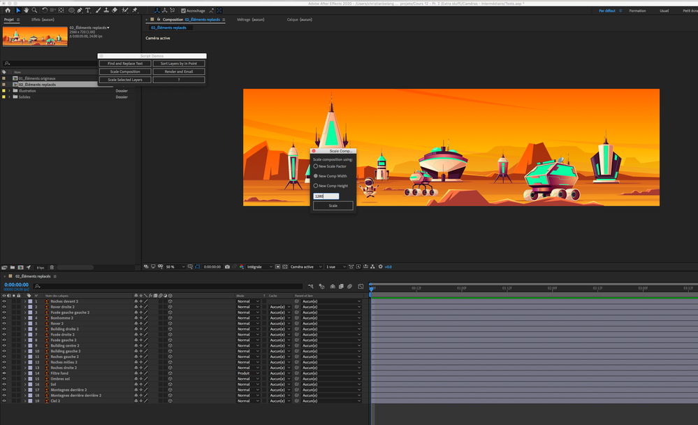

Here is what happens with the second option.
I go to the File/Scripts/Demo Pallet menu and choose the Scale Composition option, then I enter the new width for the composition:
a
Then I adjust the height of the composition:
The, with a camera, I add a camera and reposition it to frame up the part of the scene I want to see. When we compare with the original, everything shifts again:

When you pre-compose a 3-D layer you just collapse transformations, you never make the Pre-comp 3D.
