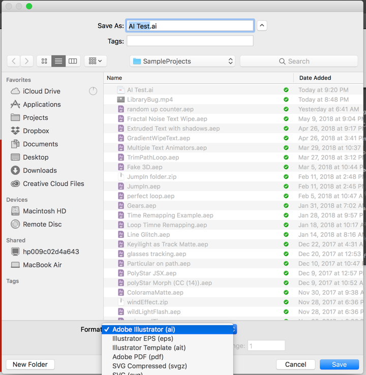

When you save a file this dialogue should pop up.
That should fix the problem.

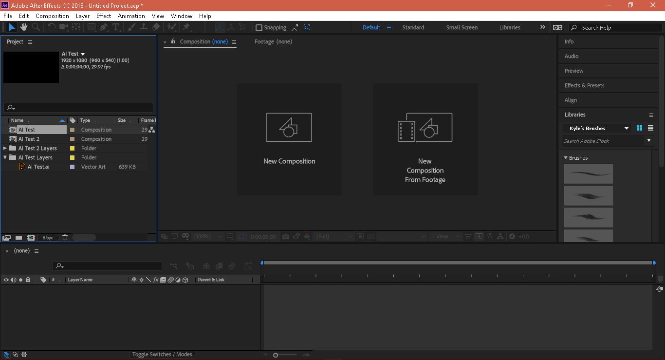

New Here ,
May 18, 2018 May 18, 2018
I went back to re-install again illustrator and later i create the new document with you instrutions but nothing happen U_U

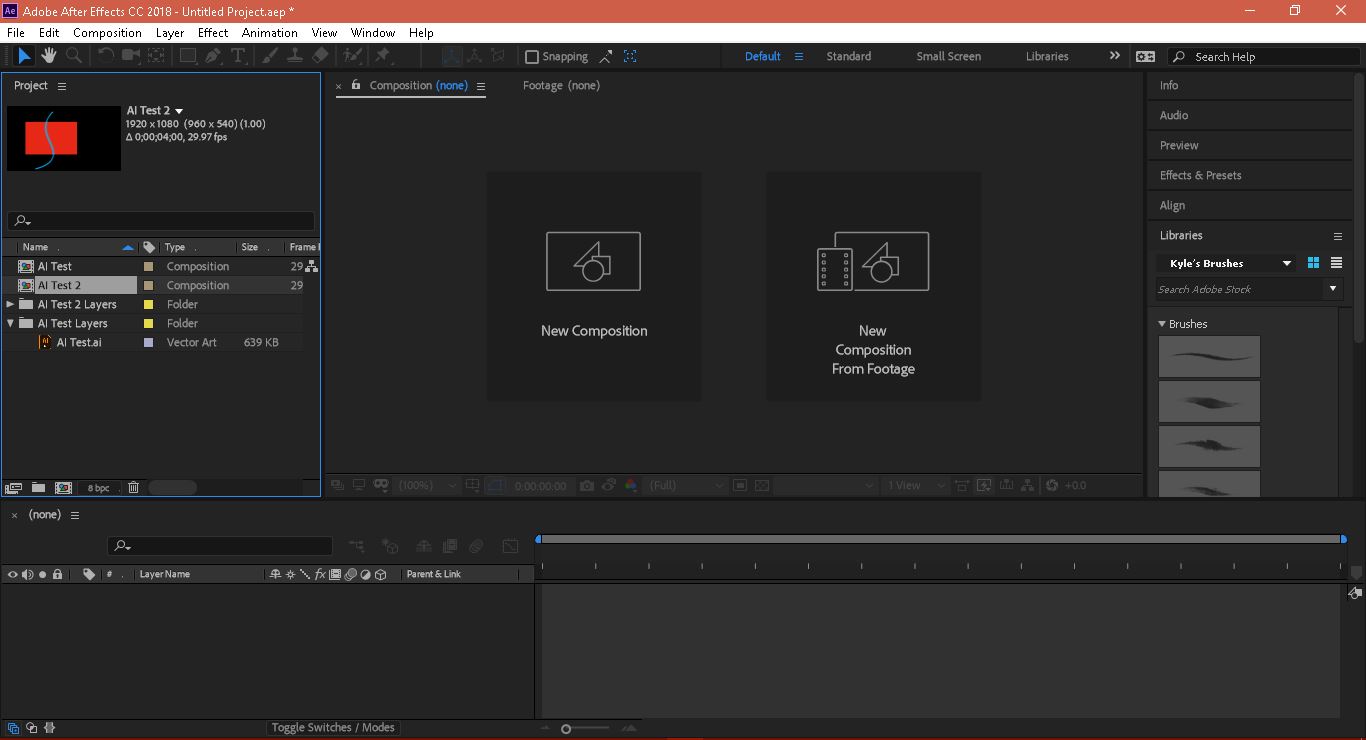

Try this file:
Dropbox - AI Test.ai
If your browser adds a different extension just delete it. Open as a comp retaining layer sizes and you should see two layers. If that file does not work the make sure AE is up to date. If it works, make sure AI is up to date, reset all of the preferences in Illustrator, and make sure the color mode is RGB. You might also want to open the text file in AI and add another line or object and save it as a different name.

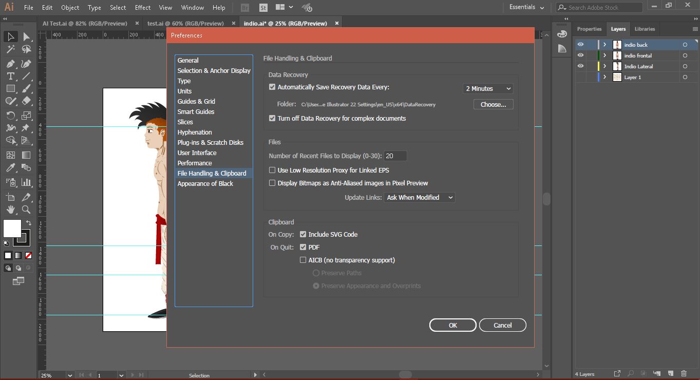

You need to check your preferences:

New Here ,
are the default preferences, I uninstalled and reinstalled the adobe illustrator and reset the preferences

Dropbox says it all:

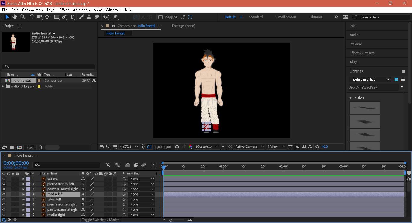

New Here ,
O_O
thanks you

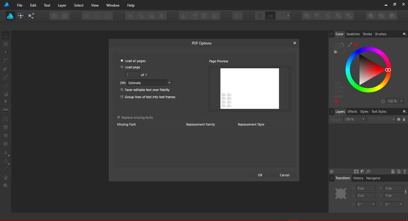

also i try to open my files with affinity but don't work
but i active this option and now also affinity can read too
