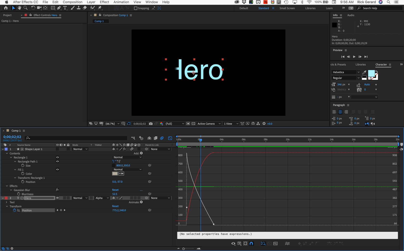

The tutorial you are watching is teaching a workflow that is only just above fair. There are several more efficient ways to animate and control that animated mask. You could duplicate that entire project with a lot less fiddling, fewer keyframes, and a lot less work.
In his technique both the position and the mask path are moving, then the speed of the enter and exit speed of the position move is modified so it's kind of a miracle that the animation on the mask does not get fouled up. If your mask does not behave as you expect before you modify the keyframes for Position then you have a workflow problem. You did things in the wrong order. If the mask does not keep up with the position change then the problem is caused by the difference in timing.
It would be highly unusual for me to animate a mask on a layer that was also moving if I wanted to reveal that layer. If I was doing that kind of a reveal I would just create a rectangle shape over the hero position of the layer then set that rectangle as an Alpha track matte for the layer. It would look like this:
No keyframes for the track matte, a little Gaussian blur added to soften the edge and a more efficient way to see what editing the speed graph for Position is doing to the move by showing the reference graph make that part of the project much easier.
When you get all of the elements into their hero position you can just add a null, make that null the parent of all of the other layers and fly the entire animation into the shot in 2D or 3D space.
If you still can't figure out what is wrong, post a screenshot with the modified properties of all the layers giving you problems revealed. Just select the layers, press UU, PrintScreen and Paste or drag a screenshot to the reply field on the forum and we should be able to help you figure it out.
