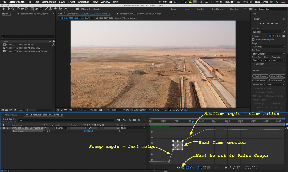

Apr 19, 2020 Apr 19, 2020
If you set up a loop you can Pre-compose that loop again and run Time Remapping again, then add and manipulate the keyframes to change the speed of the playback. It takes a little practice but viewing the angle of the Value graph in the Graph Editor while moving keyframes back and forth will give you an idea of how the playback is working. The flatter the line means slower, a steeper line means faster, if the line is horizontal playback stops and if the angle is down the movie is playing backward.
