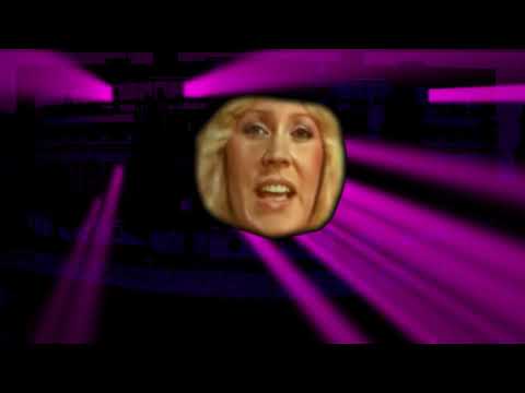

I can show you my work sofar, its a deepfake with Agneta from Abba and some rays, its not edited at all and in this clip I have not used any color range key on her eys. Just to give you some idea:
Uploaded by StoneWaterGlass on 2021-10-01.

I have followed Arrons Comp. and I get a nice shadow from the actors head-clip but the head is black. I have tried to add a ambient light but then the head starts to emitt fastblur. It looks nice but its not what I want. I have tried to duplicate the head-clip and put it on top of the composition and used a ambient light and this works partially, I see her face but there is still comming fastblur from the face from the back somehow. Maybe I could render the  comp with the head black and then add the original head clip on top of this in another comp and render this? That way her face should not be black? Maybe not the easiest way.... In the screenshot her face is the small black triangle
Explorer ,
Oct 05, 2021 Oct 05, 2021
I also tried color range key in her eyes and there is no problem to get the rays through, good!
Explorer ,
Here is a better image you can see the rays through the eyes. I have also tried to first render and then create a new comp and put the original clip on top in the comp and it seems to work, her face is not black anymore.
