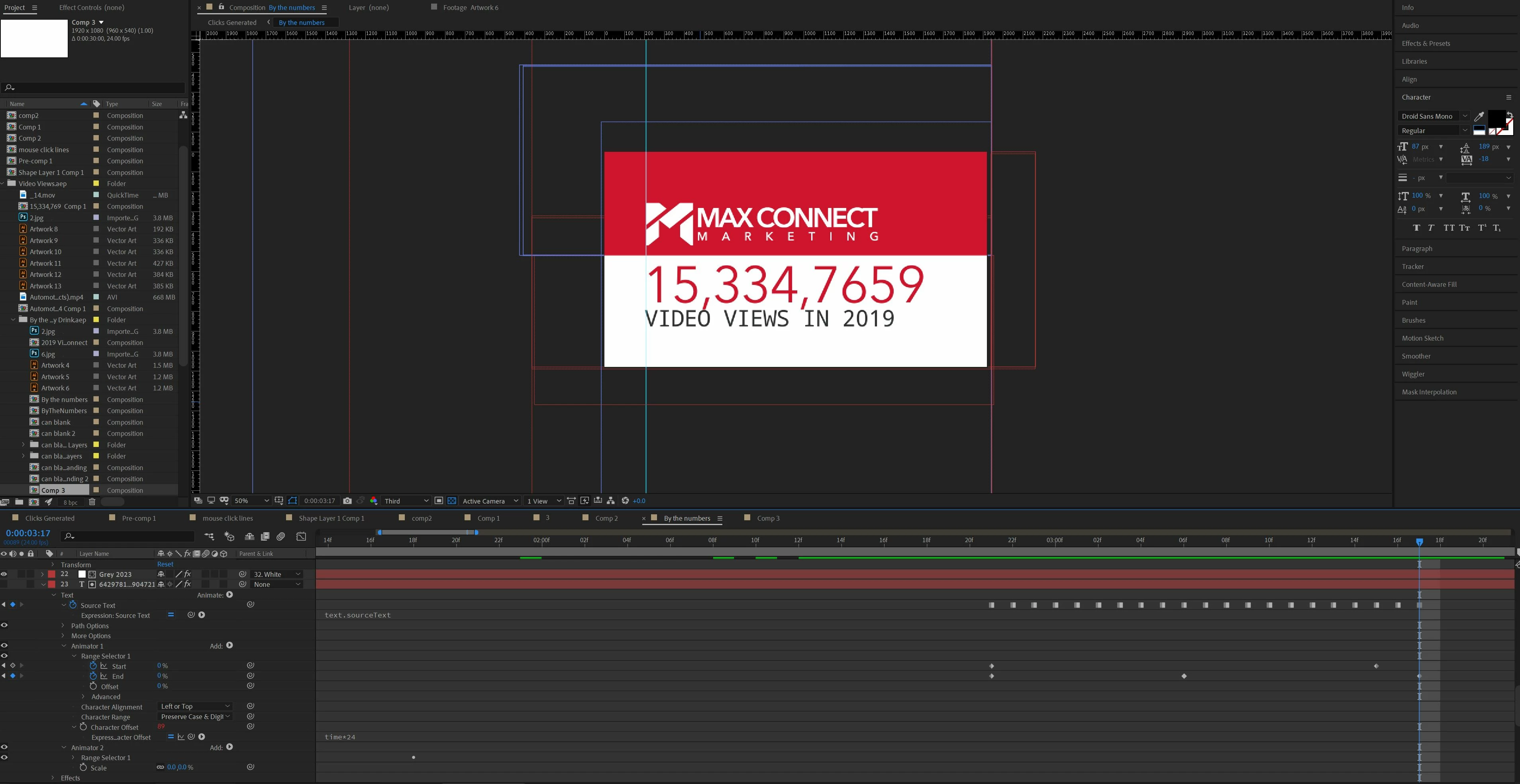

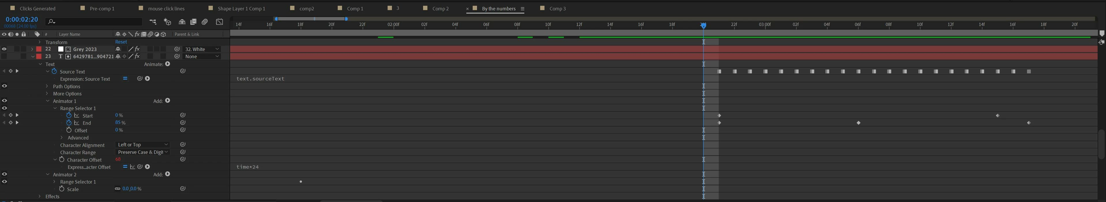

I am making an animation for work and found a way to get the below words "Video Views in 2019" to animate from random numbers to the actual source text I want. I wanted to know if there is a simpler workaround to doing this a lot faster. What I did was made the same number of characters as the source text, added an animator-range selector, then made the expression for the offset time*24, then I added a second animator-scale to add the numbers one at a time right to left. then I changed the source text one letter at a time, while changing the range of characters being randomized fram by frame. Until the phrase I wanted came in. The project is related to numbers so I wanted it to be only numbers until the actual text . Is there a workaround to make this a lot easier? I got the idea for this way from this youtube video: https://www.youtube.com/watch?v=1WZy_O_kJ_Y
