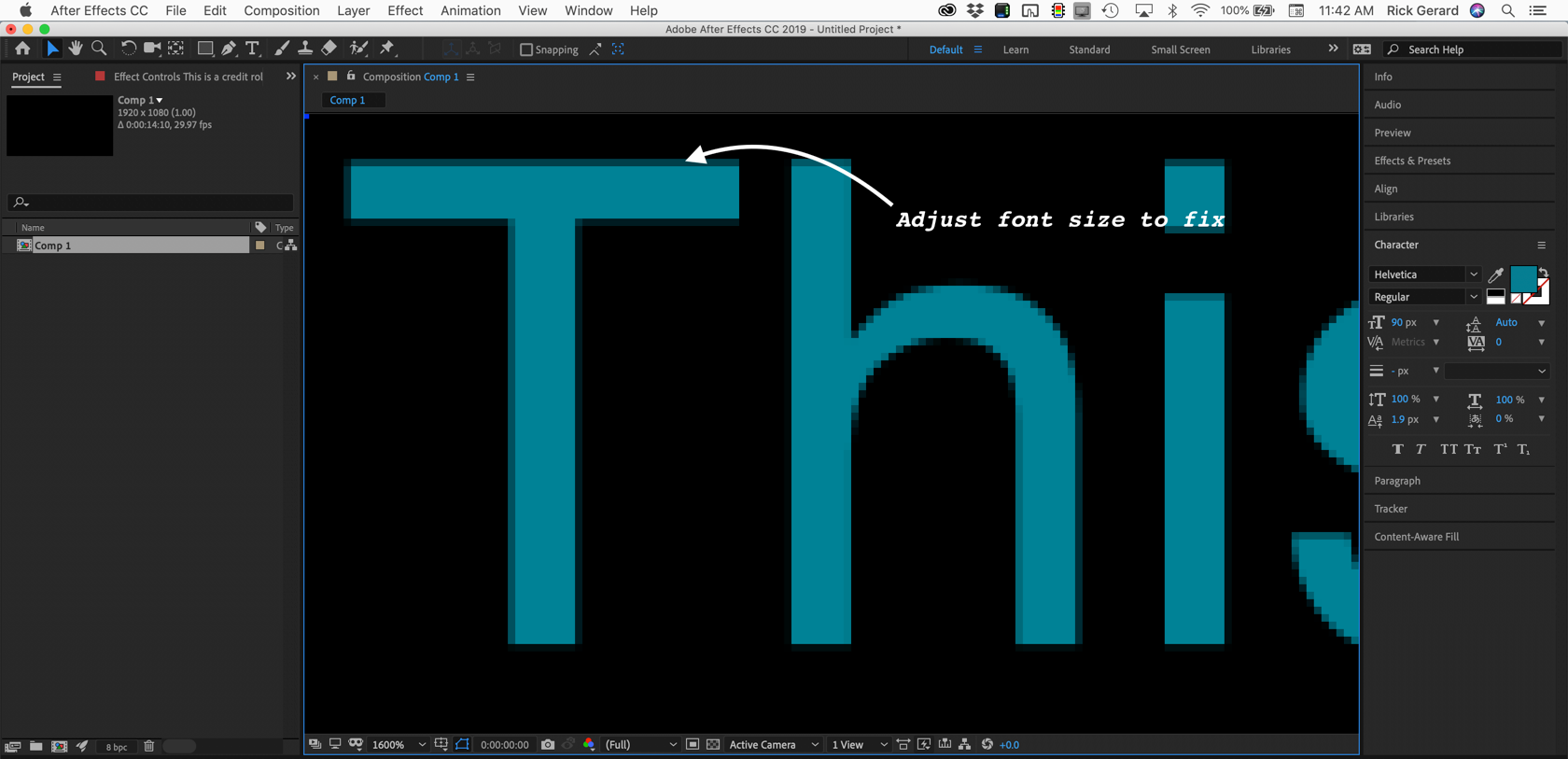

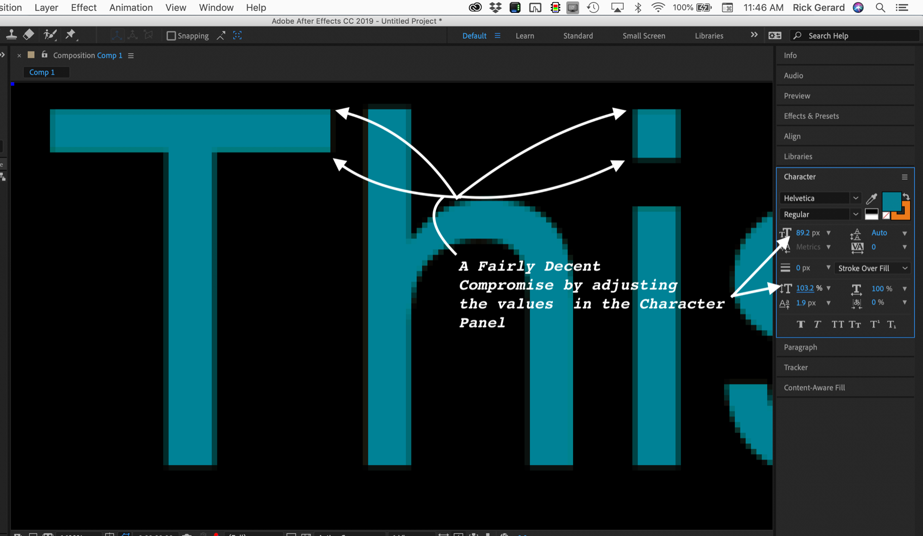

Perfect rolling credits - Hollywood style:
    • Make sure that the font is thick enough to avoid antialiased top and bottom edges of the majority of the characters
      This:
      Becomes this with a little tweaking and you can see it at 800% magnification factor:
  • Make sure that the titles move exactly an even number of pixels per frame - you can't fudge on this
  • If you must slow down the credit roll at the end then thick fonts are a must, you can't have thin lines slowing down, it just will not look good
To slow dow
      This:
