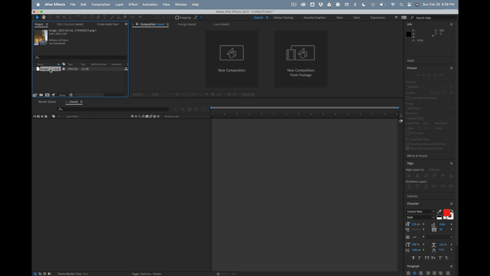

What I want to remove is this corner here. 3 straight lines and the top of the sofa and for some reason Roto brush doesnt want to do it.
