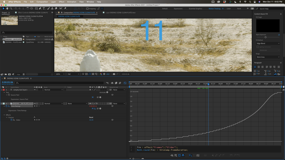

Throwing in Math.round means that you will get frame 0 for the first 2 frames, then frame 1 for the next 5 frames and frame 2 for the next and so on until you get to frame 60 at 0:09:28.
Here's the graph editor showing the results with the rounding vs the time value with no rounding. Notice the stair-steps.
If all you want to do is assure that every frame in the comp is not a blended frame, all you have to do is add the expresson control slider.
Now, if you convert the expression to keyframes you will have whole frame values for each frame. I don't know what you want to do with that information, but that is the way to get whole frame values for all your keyframes. It even works if you put in a bunch of easing on the Slider Control keyframes. You can get something like this:
I hope that makes a little more sense. Using the slider and math.Round will give you exact frame numbers for every frame of the composition.

I would add the expression control slider to perform the time changes you need, use the second expression, then convert the expression to keyframes. See my Graph. You can have any speed changes you need in the project and export a precise frame number to Maya.
