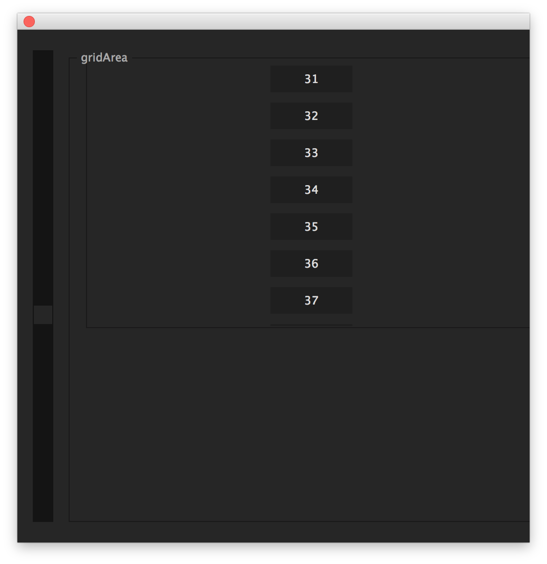

Helloooow wise scripting peoplez.
I've been gnawing my fingernails over this problem the past couple of days, and still haven't found a solution. Here goes:
I've tried to make a window(or actually panel, because in the end it should be run from AE>Window>scriptname.jsx ), with a scrollbar, that can scroll through content in a group next to it. I can get the group to scroll and all that, but the problem, right now is, that after x items in the group, the last ones get clipped off. Like this (there's supposed to be 500 buttons):
The only way I've been able to get the "inner" group to get bigger is by not using any of the align properties and set the .size manually. I know the content is there because the last item shows up, when I'm moving the last items location[1] upwards until it reaches the top of the group. I tried making the layout refresh (layout.layout(true);layout.resize()) at every call of the onChanging() function of the slider, but w/o success. Reading lots of lovely forum posts and discussion by @Marc Autret  and other long time scriptUI/extendscript users has this far been without luck.
TL;DR:  I'm trying to make a group with lots of content that I can scroll through with a scrollbar.
here's the code snippet, hopefully well enough commented :

I'm not noticing any clamp on UI size that might be choking the height. It appears there may be a draw size limit to containers. I changed your panel to a group and squeezed an extra half button after 33, but nothing more. I'll keep looking into this. Your script build style is different then what I am use to, so I am translating in my head what's doing what.

I just finished replicating your code in a more familiar way to my mind, and I am getting the same exact results, but only in column orientation. When I flip it to row, I can get up to 41 buttons showing before hitting the size limit.
This unfortunately seems to be a container size limitation of some kind. Perhaps Todd or another developer could expand on this.

All containers and widgets have a maximumSize, which is at most the screen bounds, and maybe a bit less.
So you can't have a panel 9000000000 pixels high. The height will stay stuck near the thousands.
So, since you have no chance to make a panel big enough to carry those 500+ buttons, the panel height should be same as the scroll height, i think, and not move. Only the buttons would move.
One way would be to add 500 buttons to your panels and play with visibility.
Buttons that are assumed to be outside, turn them off, and position only the other ones.
Or you can play with periodicity: if there are at most 20 buttons visible at a time, make a panel with 20 buttons, and modify their text/position according to the scrollbar.
I think i'd go for the second one. Lighter. But if you have other things to show on the sides that have to slide too but can't be swapped, it won't work.

Ok, this has just become a personal challenge or something now. I am so close to getting it to work. If you swap out the scroller onchanging for the below version. Things all move, but get progressively faster as you scroll down. Also there is a lag causing the UI to not always update and the locations tend to remain offset if you scroll too fast.
scroller.onChanging = function(){
  var kids = gridArea.children;
  var kidsLen = kids.length;
  var ySize = kids[0].size[1];
  var fullHeight = (ySize*kidsLen);
  var shiftVal;
  for(var k=0; k<kidsLen; k++){
     shiftVal = -Math.abs(scroller.value, kids.location[1]+scroller.value);
     if(scroller.value > scrollDiary){
         kids.location = [kids.location[0], kids.location[1]+shiftVal];
     }else if(scroller.value < scrollDiary){
          kids.location = [kids.location[0], kids.location[1]-shiftVal];
  scrollDiary = scroller.value;
Explorer ,
Oct 14, 2015 Oct 14, 2015
haha, that's awesome!
Looked at your newest version and it seems to work alright. Your scroller has kind of the same problem I had when trying to move the children individually.
I'm at it again as well. Keep me posted on your progress.
Explorer ,
Aaalrighty, guys. I seem to have cracked it.. Sort of..
David, your version worked pretty well, I just modified it a little to have the right math.
The scroller is working as expected now and the scroller.maxvalue is calculated by ((number of items)*height of first item).
Everything works really well until I start using the auto layout manager. The 'fill' option at least makes it really hard to figure out the final height of the inner objects. So they should be set consequently.
anyways, here is my modified code (sorry, @David for the non-resource string based version, you can maybe just copy the scroller.onChanging() and populateGrid() parts x)  )

Nicely done Fynnay. As a heads up I did notice some slight bunching of the 3-4 images towards the last three quarter mark on my end, but may be just me. I am trying to port your solution over to my build now.
